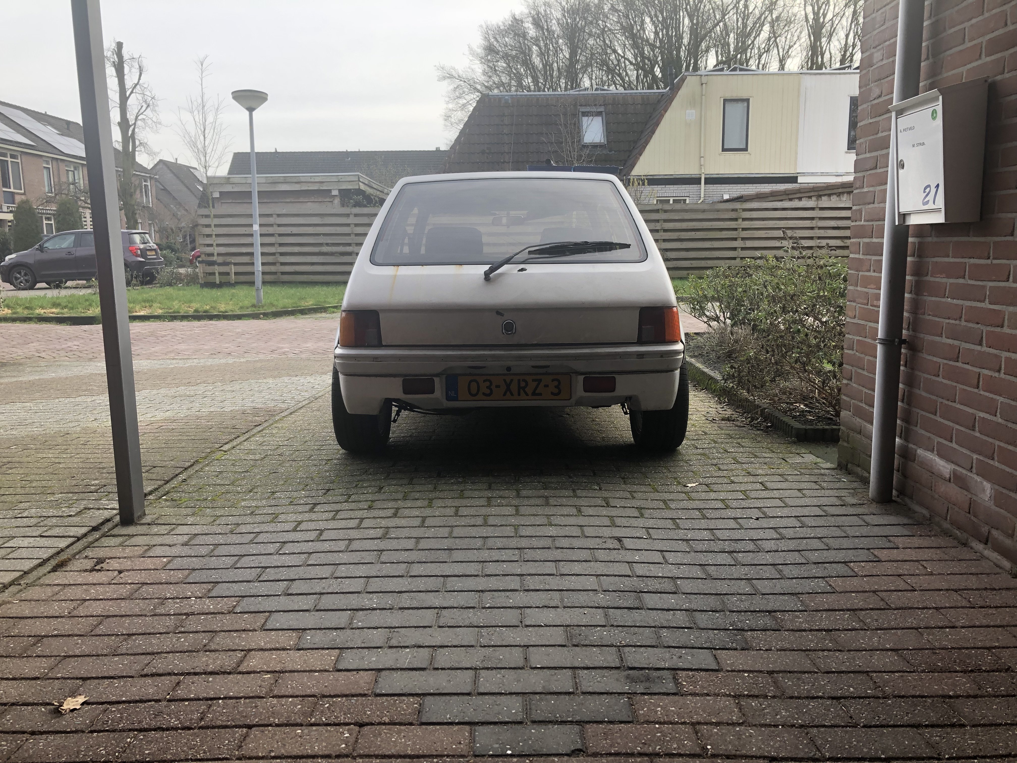

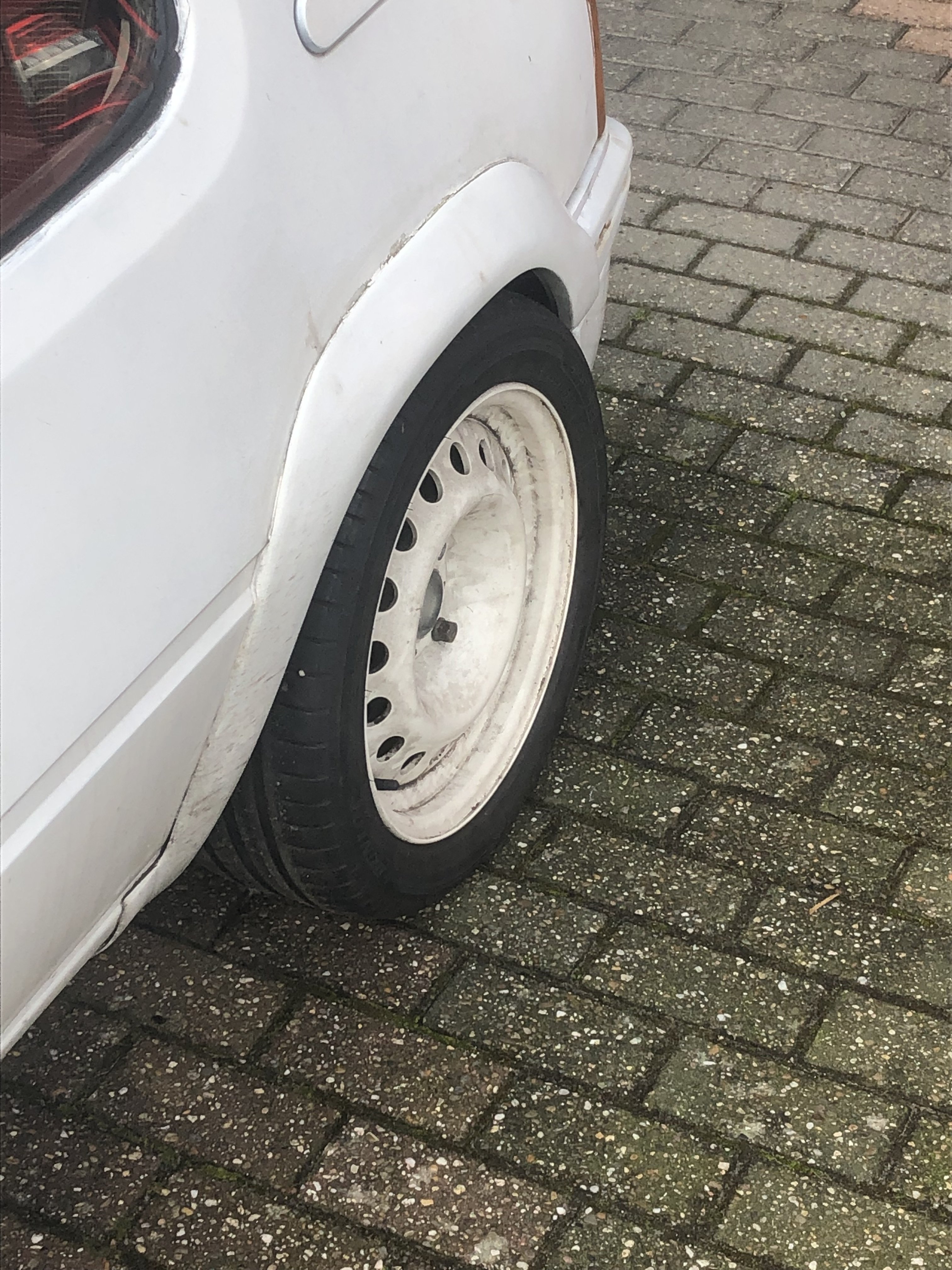

underneath with plus 65 track and c5 aluminium “steelies” and fake arches

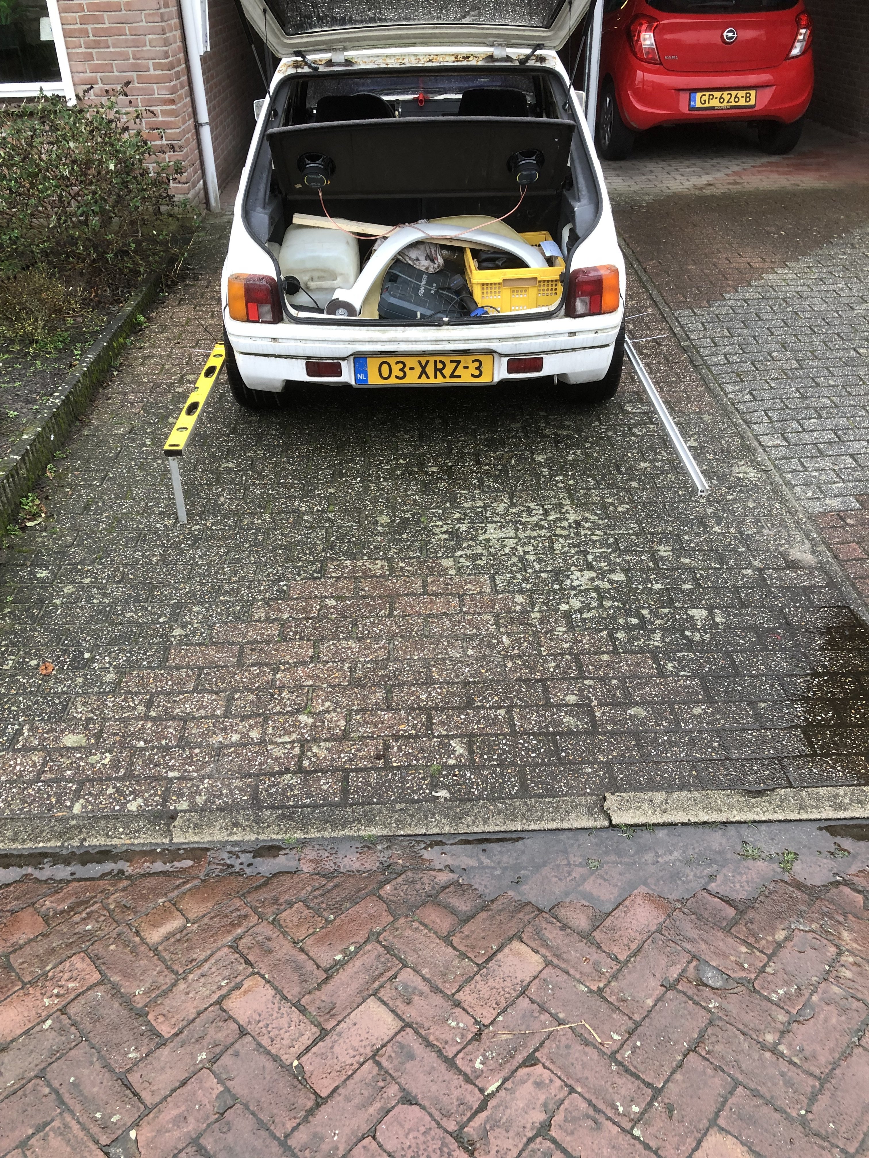

How can I check toe with basic tools?
Make a big U, which can slide in under the car. Measure the rim track and 3 and 9 o'clock. Subtract the difference.

String box the same as home tracking then measure front and rear of the rim.
Arthur
Hmmm. I would have to check with better tools one day. I measured 3 deg camber and toe.  Arms about horizontal.

About 20mm on a 15 inch rim. But measured 3 times and different data each time so not reliable

Well so much for theory and visuals. It’s 8,5 mm @15 inch —> 1 degree camber and 2mm 0,25 degree toe.
306 cc 2.0 disc arms on a 205 beam with horizontal arm angel.
I guess that’s about best I hoped for but all theory down the drain.  This is also what I measured on the 2 different arms when all was off the car AND the reason I fitted them stubbornly.
