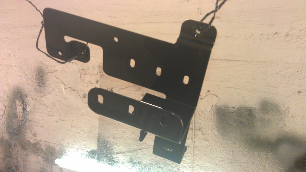

Really not done much still since before the summer. The 407 has caused me too much grief, but I think it will be in good working order with quite a few freshly painted panels now.
Just painted the relay bracket the other day so I can put the rear beam wiring in once for all now.

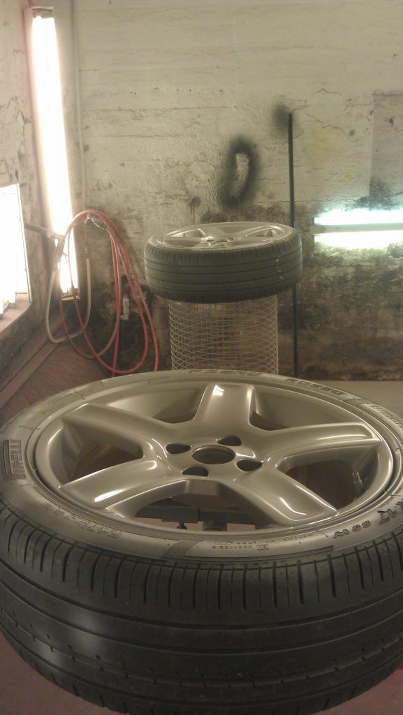

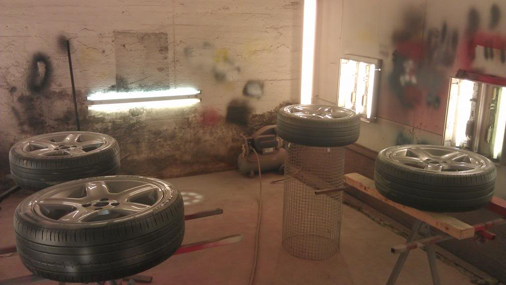

Also painted the 17" wheels. Not done yet. Put acid etch, surfacer and metallic color on now, but need to do some slight sanding in some areas and put one more layer of silver before laquer on.

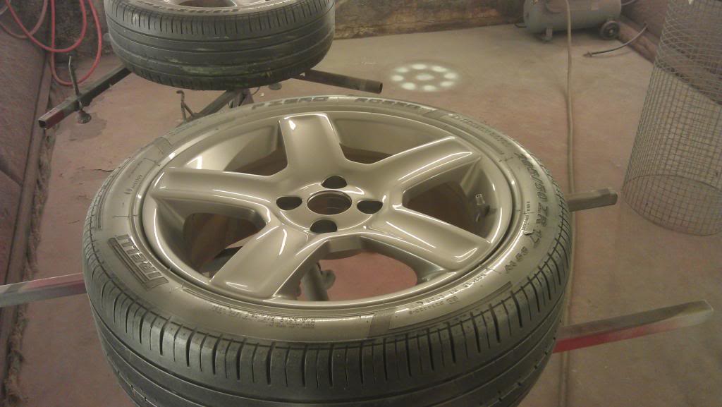

Now I've put clear coat onto the wheels. Turned out quite nice, no runs as I could se either... always hard to avoid :)
Now I just need to paint a set of 1.9 Gti wheels that I'm refurbing. When that's done it's time to get the T16 into the paint booth and start spraying some high build primer on it!

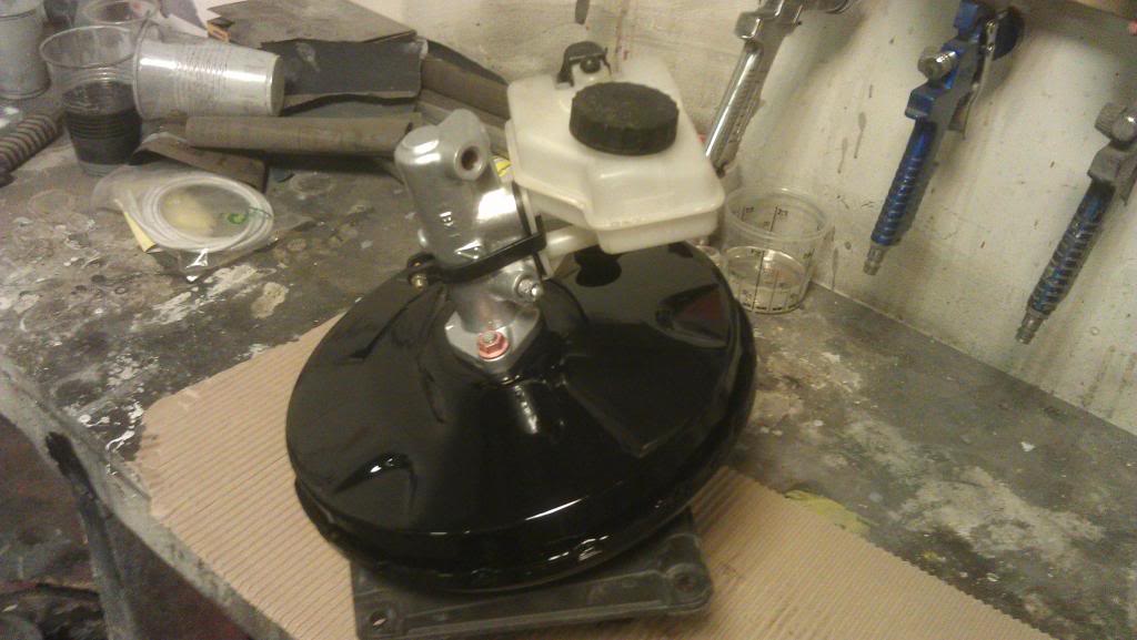

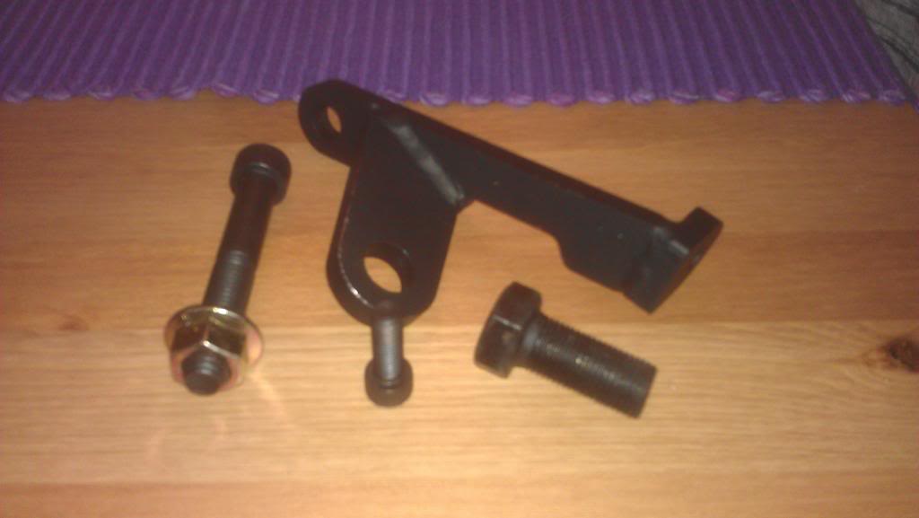

"Overhauled" (painted) the brake servo and master cylinder, so they look quite ok now smile.png
Also recieved the transferbox strengthening kit from Charles today.
imaS
Where exactly that stiffener will go?
B1ack_Mi16
It's to replace the orginal bracket between the block and transferbox which were mounted on some cars.
Orginal
Replacement
The new one will allow for better space for larger downpipe also.

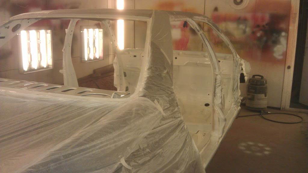

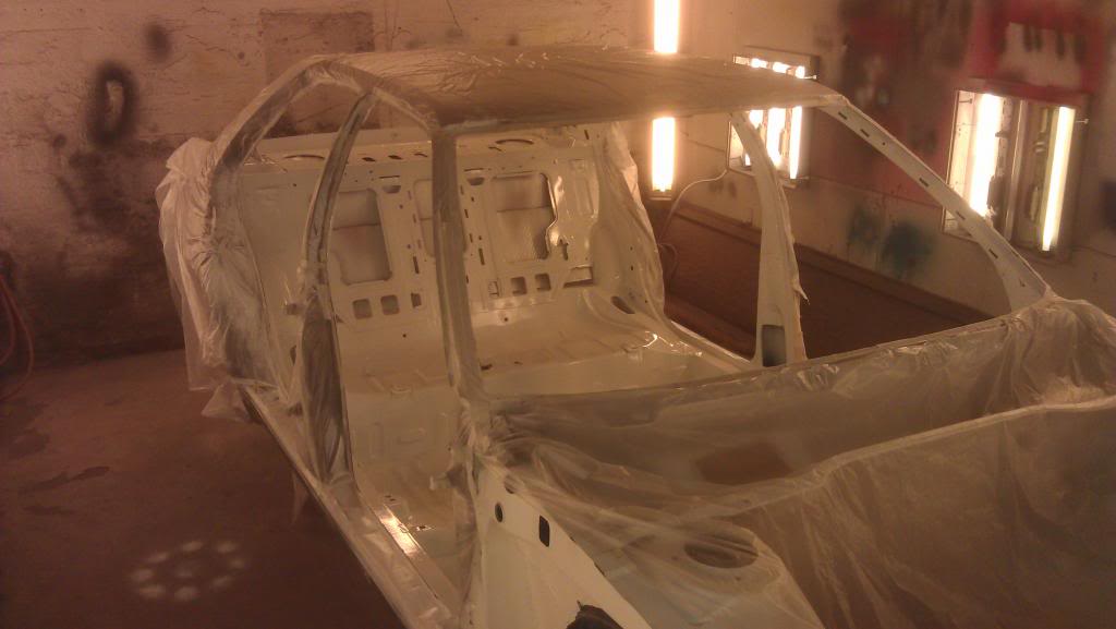

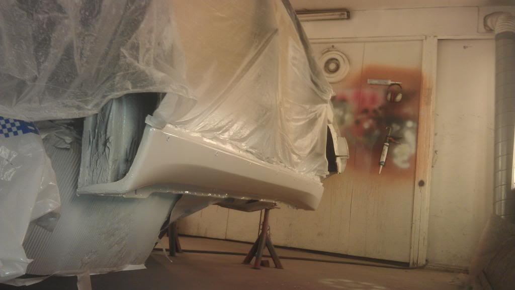

B1ack_Mi16

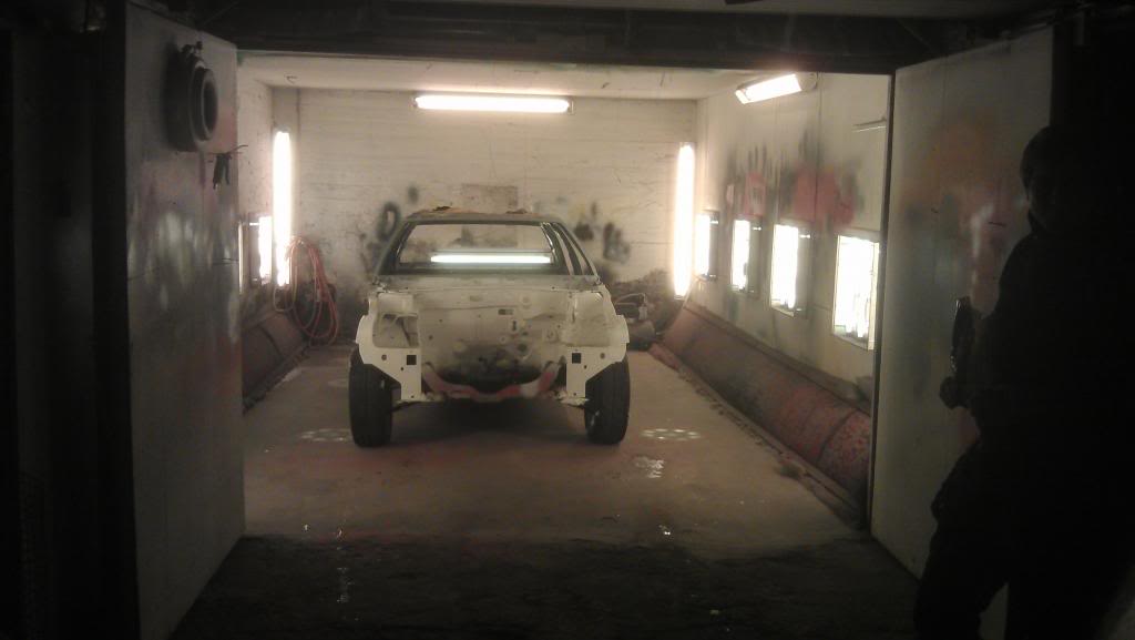

Moved it into the paint booth now
Will take off the front wishbones etc. before I start painting. Also has to do a good masking job to avoid getting paint dust on the underside :)

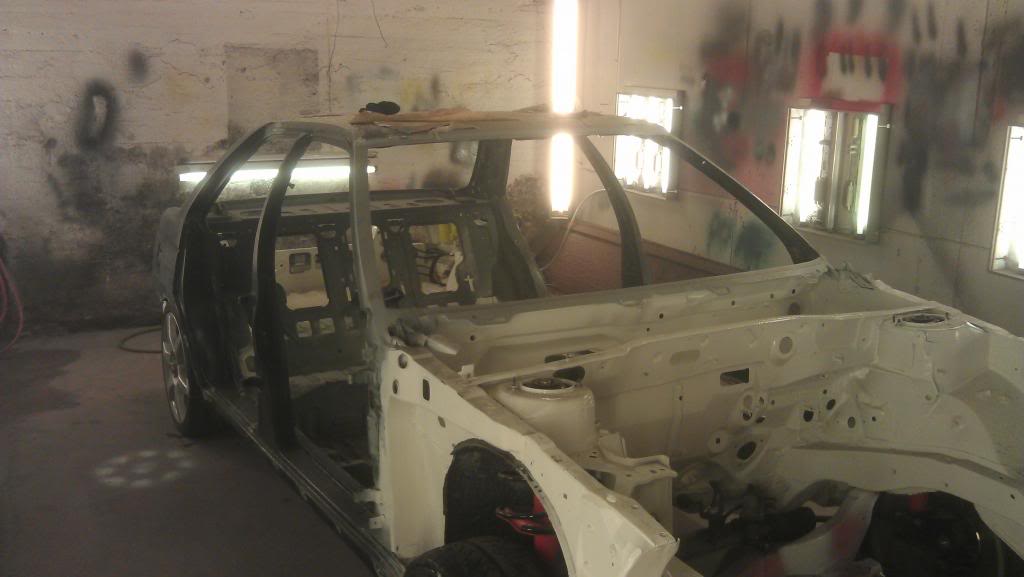

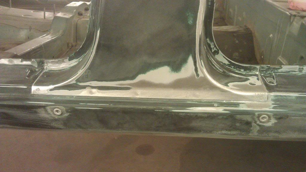

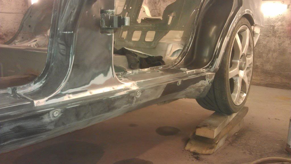

It is impressive how much hidden small spots of rust there might be on these 405's really.

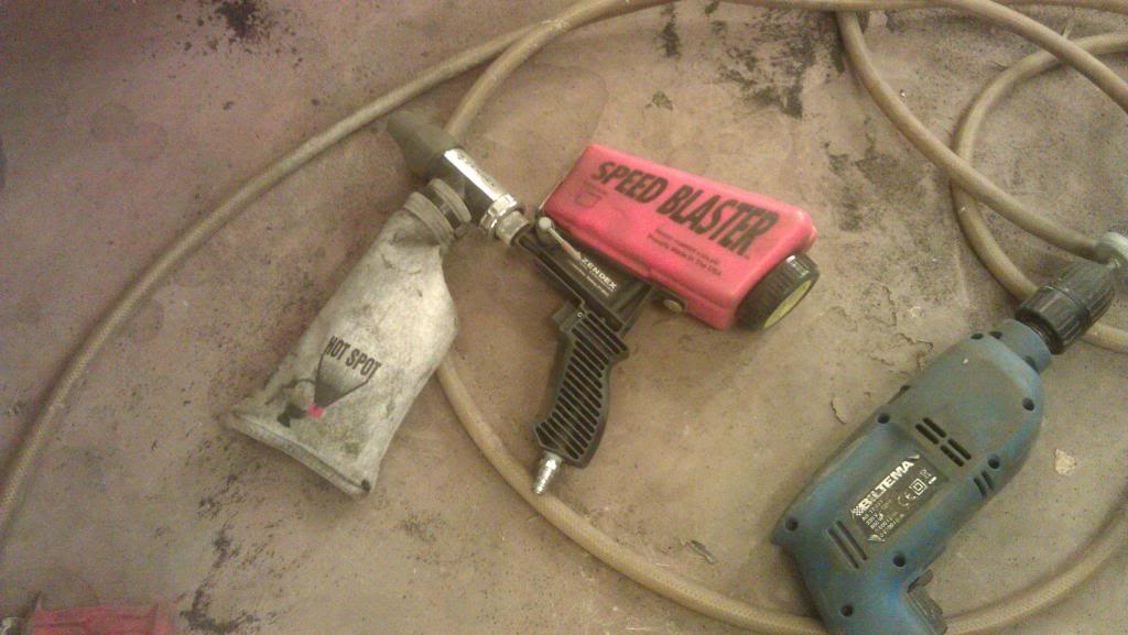

Started to prep the sill area for paint and noticed that there is rust under the good looking paint over all the spot welds of the B-pillars to the sill, will possibly find more other places when I start looking.
Luckily I bought a spot blaster gun not long ago, it comes in handy now :)
johniban
love the look of fresh steel, will have to get myself one of them spot bead blasters. they any good? i guess they are good for now making a mess everywhere
B1ack_Mi16
Yes it works suprisingly good, and will collect most of the blast media in the bag so it can be used several times.

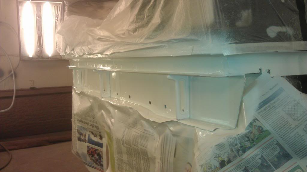

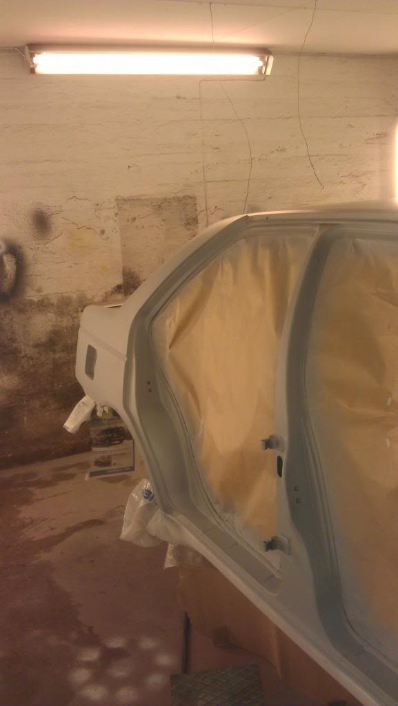

B1ack_Mi16

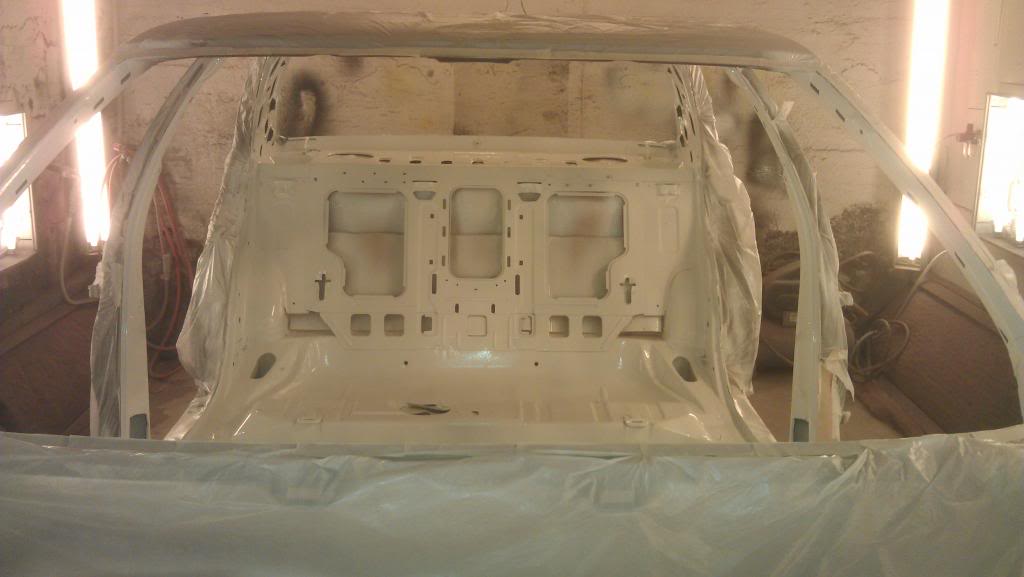

Sprayed it inside today, so then that's done :)

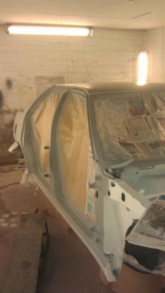

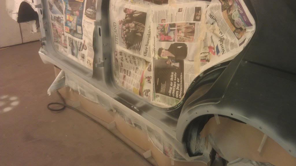

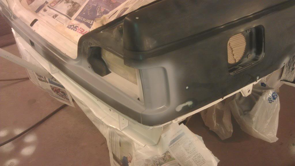

B1ack_Mi16

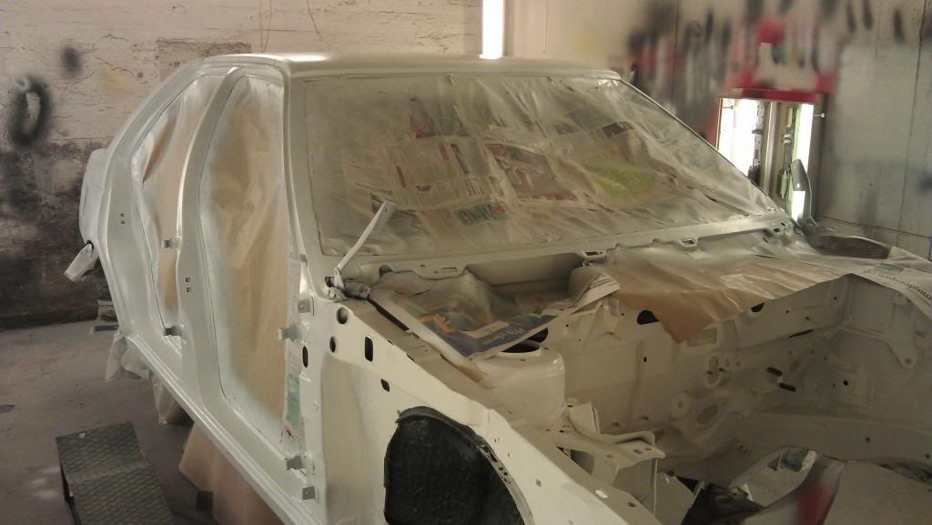

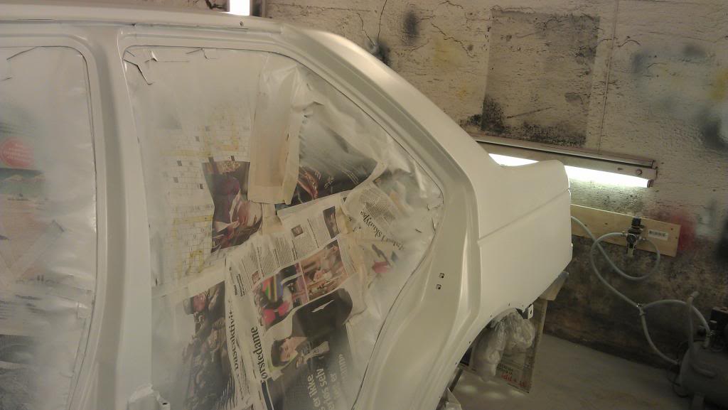

Started doing some prepwork and priming some areas of the outer shell now. :)

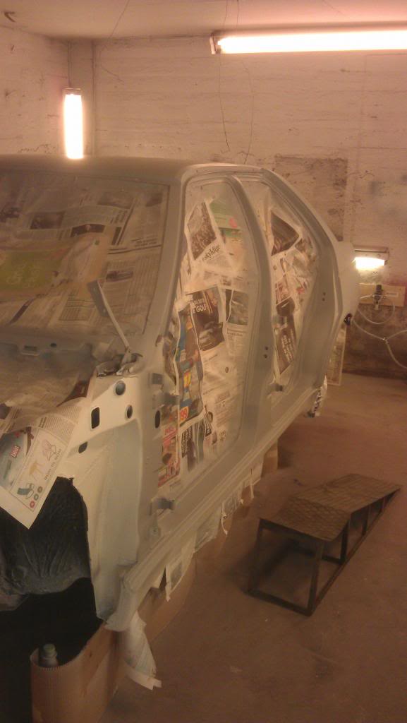

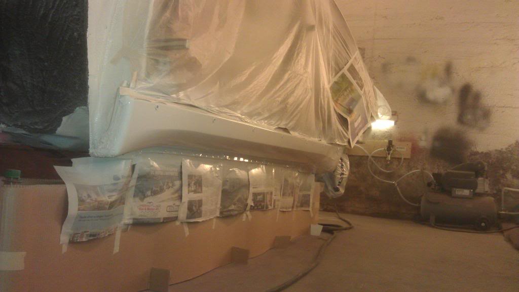

B1ack_Mi16
Sprayed 0.6 litres of epoxy this evening.
I'll do some sanding at local spots where it is needed, need to inspect it next time and do some touch-ups and add some sealant on a few spots before I spray the sanding primer.
I start to feel that I'm getting somewhere finally :)

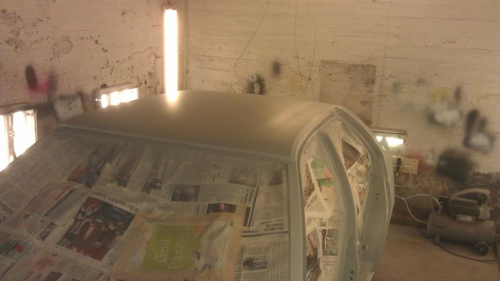

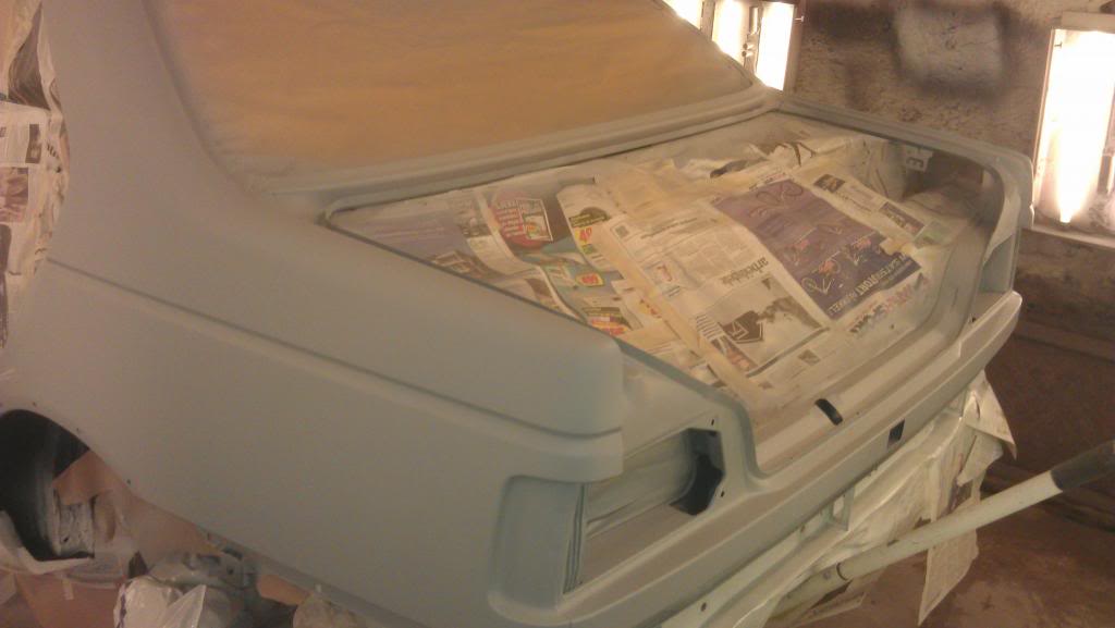

B1ack_Mi16
Applied sanding primer today, sadly I got a few runs... damn it.. just hope I manage to sand them flat then...
But one step closer to color at least.
