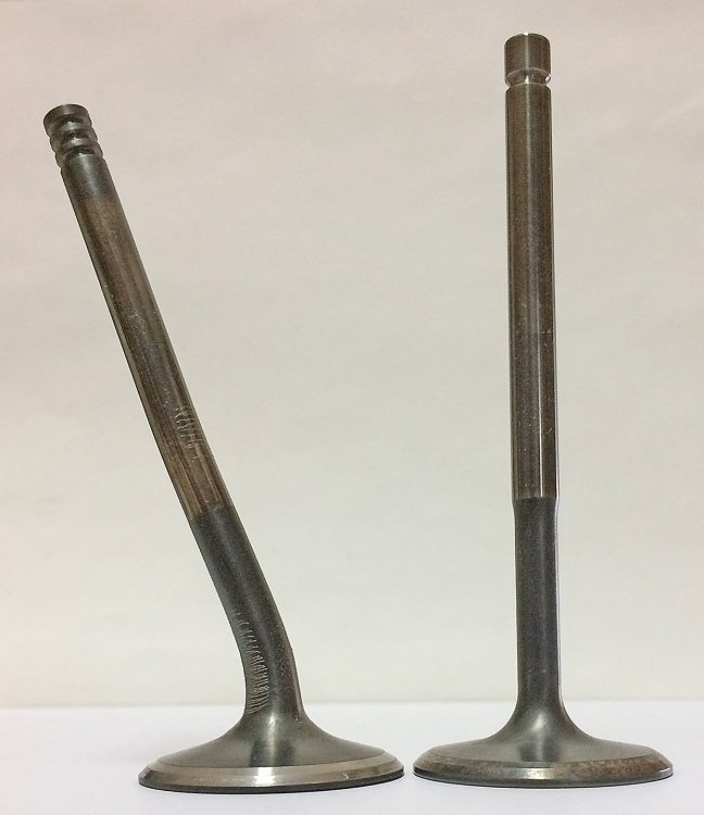

A further update today after removing the pistons this afternoon. Other than some bruising on the piston crowns they appear to have survived the encounter with the valves as have the skirts and cylinder bores.
Big end bearings will need replacing as I expected.
The company handling the rebuild told me today that when they were removing the inlet valves, the head dropped off one as soon as they compressed the valve spring to remove the collets.
So a disaster as things went for a 6 hour old engine could have been a lot worse with just a few more piston to valve collisions before further damage.

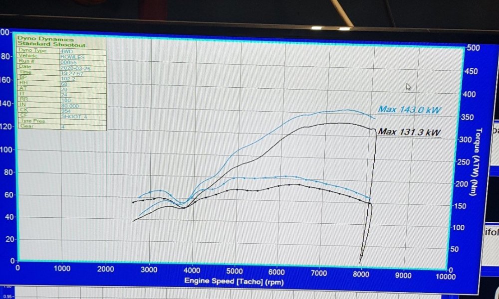

As per my previous post I was reluctant to spend more $$$ on the car. I umm’d and ahh’d about (the spend) for a few months but in the end I convinced myself that a), the upgrade to 2.2 litres didn’t achieve the hp I expected -the black line and b) I still wanted to sell a car in top mechanical condition.
Paul, my tuner had previously identified the shortcomings of the exhaust system. It has one of Miles 4-2-1 manifolds thermally heat treated inside and out, a mish mash of hotdog and pipework to a rear Devil rear muffler probably only designed for a standard engine to give a nice note.The pipe diameter might also not suit the high horsepower intention.
So, cheque book out and the cam specs, inlet valve stem diameter and cam timing were provided for a new extractors back system to be made.
The combination of the new exhaust, the better profile of the inlet valves as well as a wasted stem in the port area (7mm - 6mm) gained a significant power increase. The only disappointment I couldn’t find a road tyre/rim offset combination to clear the Brembos and coil over spring platforms for the power runs and cost myself around 5-6Kw by using the AO 50 Yoko race tyres.
Now the result will probably be underwhelming to those in the Northern Hemisphere because you calculate you’re power in a different way. Likely flywheel power is around 180 - 190 Kw.
But here’s the result the way we measure things in Oz.
Edited by JeffR

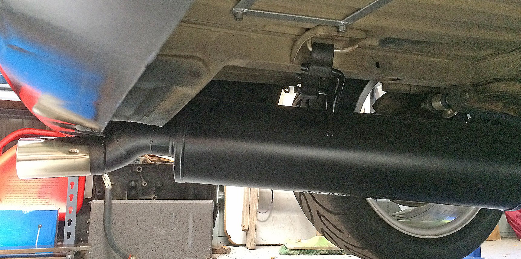

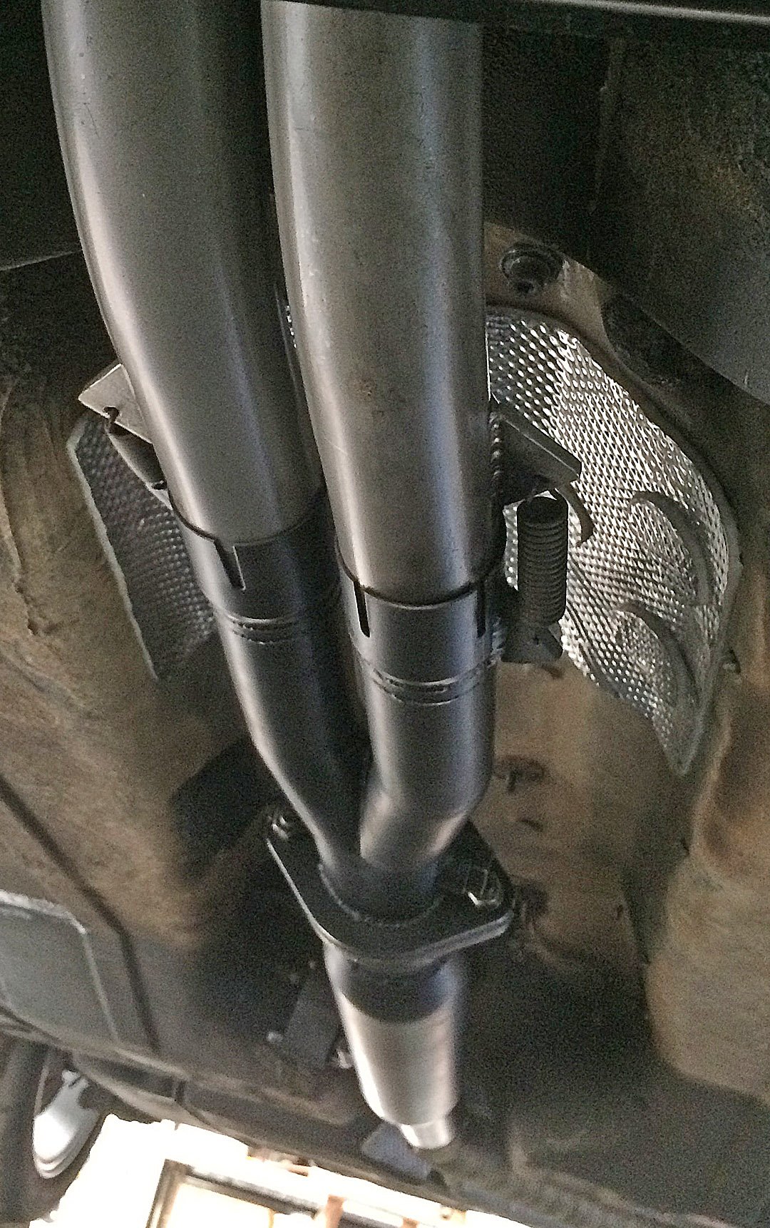

While I had the car on jacks to refit the under tray today, I took a few pics of the new exhaust.
First up was to replace the 2-1 merge collector which came with the extractors. Not a good flow for a performance engine. I kept the spring joiners from the extractors. IMG_1338.thumb.JPG.d2389b2179c23f6cdcfbd86fe42c984e.JPG
A centre resonator (hotdog) and pipe work much tidier under the fuel tank and rear beam. I also had a heat shield applied to the bottom of the tank and the pipework wrapped.IMG_1341.thumb.JPG.a40a918eea4058fd3f972e89735782a8.JPG
 Finally a large better flowing rear muffler to hopefully keep the noise levels to around 85Db.IMG_1340.thumb.JPG.942000900cd4ab72e994a422826af52e.JPG
Really pleased with the workmanship.

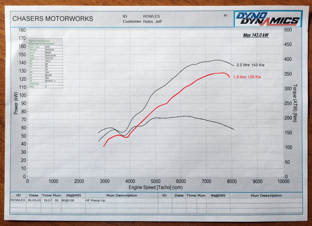

While I was cleaning up my data notes on the 405, I thought it’d be a good exercise to plot the last dyno run of the 1.9 engine compared to the current 2.2.
The overall maximum increase of 14Kw only indicates part of the improved result.
In the 4500 to approx 7200 rpm the difference is appreciably greater with gains upwards of 25Kw.
I didn’t have a comparable torque figure for the 1.9 as it was expressed as Tractive Effort, and difficult to convert to Nm.
I think a number of factors were responsible for the improvement-
1. Larger bore 87mm up from 83.5mm so unshrouding the 36.5mm inlet valves,
2. Better valve profile and wasted stems in ports-6mm instead 7mm,
3. Improved exhaust system more aligned to the engine spec.
To convert-
Kw to Hp x 1.33
Hp to Kw x 0.75
