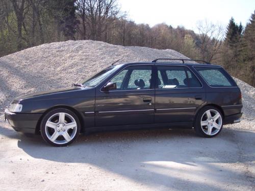

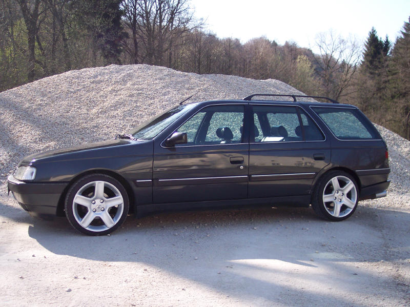

These wheels are 6,5x16...from 206 or 406. The 206 wheels have ET 28 and the 406 ET 20.
I think both will fit on the 405 without spacers - but it will looks better with some on the rear axle.
@ guater
very nice car - silver is on of the favourite color for me.
Best regards,
Dirk
Which ones will look better now? I am assuming the ET20 ones as they will be closer to outside of wheel arches by 8mm each?
I am thinking 10mm spacers... Any pros and cons?

Yes, the wheels with ET 28 are 8mm more to the outside.
On the rear axel is a lot space - I think 20mm and more per side is no problem.
Last Year I had 7x17 ET28 with 20mm spacers at rear per side and there was still enough space.
Problem with 10mm spacers...you will need longer wheel bolts. 15 mm and more there gives another system to use the original wheel bolts.
The wheels with ET20 are rare than those with ET 28 because there are lots of 206 with the wheels - 406 very rare.

Sorry, I am all confused now.
I thought that the higher the ET number is, the closer the center of the wheel is to the inside of the wheel arch - that is, the closer they are to the front strut and the engine bay. That is why wheels with high ET and over 6.5" wide will touch the front strut and therefore will require spacers, to move the inner face of the wheel from the strut to the outside of the wheel arch.
While the smaller ET number will secure room between the inner edge of the wheel/tyre and the strut.
Am I wrong?
D.B.205
Sorry, your are right. I wrote the wrong number.
ET 20 is more at the outside. ;)

Tried to test fit a 16" ET28 rim.
Appears to need no spacers if used with 205 or even 215 tyre (the original 14" 6.0 are ET29).

I've got them on my lemans (painted anthracite) they fit no problem, I think the rears would look better with a very small spacer tho. I've got some 5mm ones I keep meaning to try.
rodionski
Agree - the inner edge of the wheel is a bit close to the rear beam. I am thinking about having 10mm spacers made for both front and rear - wider track and save with inner clearance pbs.
Any opinions on whether the longer wheel bolts would be required or the original ones would be sufficient?
