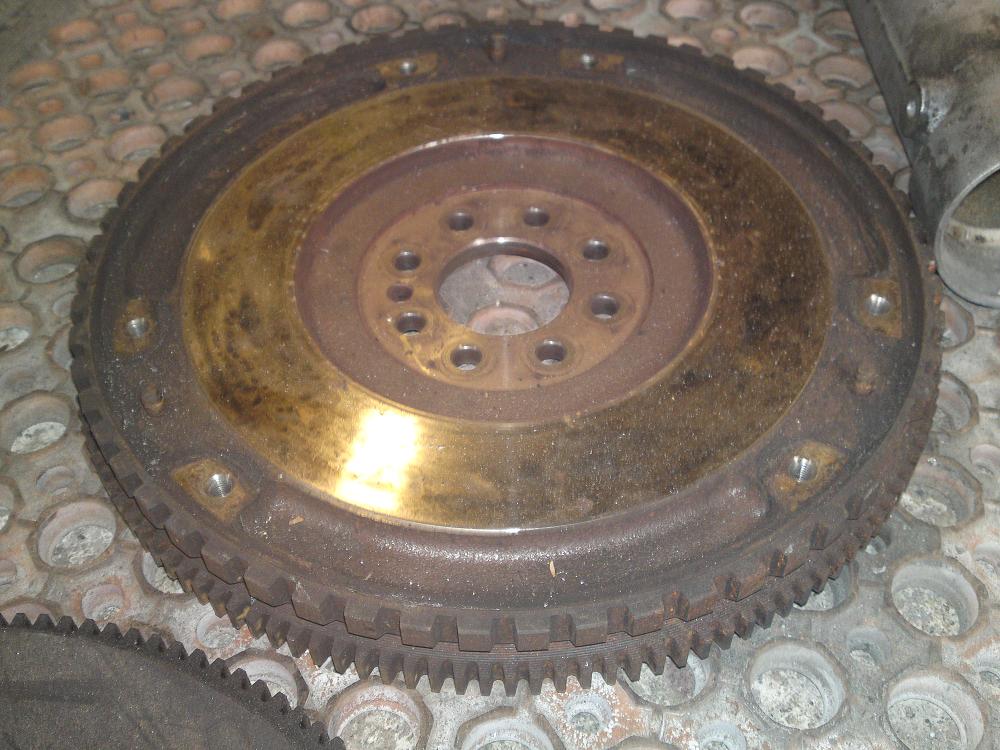

As said, you need a flywheel with timing teeth and the right CPS.
Timing teeth can be seen on this pic.
