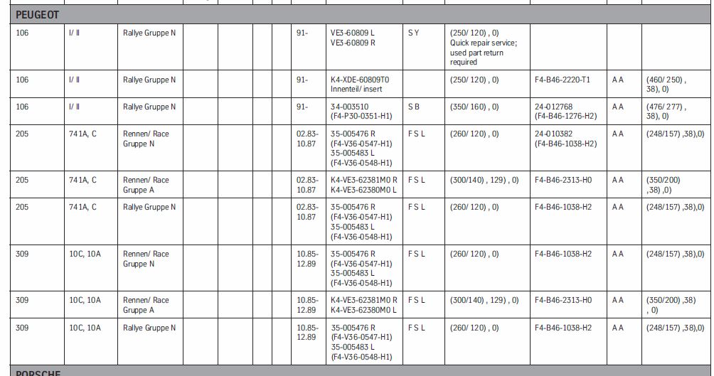

Trying to get to the bottom of what I actually have on the rear now :/
B46-1038 is stamped on the side. The Bilstein cataloague lists these as 248/157 which is different again from everything I have read lol :D
Under the motorsport section of the catalogue there is nothing listed for 306 and the B46-2313 are shown as 350/200... screenshot attached below.. the shocks for the 106 are shown as stiffer 476/277. Will 106 dampers fit a 205?
edit: right most 3 columns are the rear dampers.
edit2: worth nopting they all have a note of 38 after the damping spec which relates to damping force @ 0.29 or 0.39m/s according to the catalogue. It just says 'or' not which one it actually is, unless I'm missing something? I believe older spec damping rates were @ 1m/s which is where some of the confusion could be coming from?

Well that confuses a confusing subject even more! Are you running 1038s with 25mm bars then Henry?
All I know from using them is the 2313s have more rebound damping over the 1038s, the 306 tarmacs have more again too, they're incredibly firm!

Don't suppose you know whether 106 rear dampers are a direct fit on the 205? The B46-1276 106 dampers are shown as alot stiffer according to the catalogue than the 205 equivalent.
Kam racing has them as well listed under "Peugeot 106 - Bilstein Group N Tarmac Dampers"
Even the gravel ones are alot stiffer according to the Bilstein catalogue. 460/250 as apposed to a minor increase for tarmac: 476/277. Hmmm this seems to be a bit of a mine field.
edit: I give up.... the online bilstein catalogue lists the 106 mtorosport dampers, the B46-1276 or part number 24-012768 as 290/180.... confused ahah
