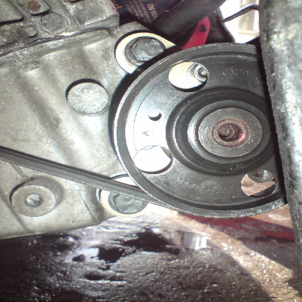

Dave, your car has power steering if I remember right? So may need some extra work to move the power steering pump down onto a sump mounted bracket to clear the inlet/bodies at that end of the engine.
d7ve_b
Tom you are correct regarding my car having PAS, if it was less work I'd be tempted to remove PAS.

The power steering is a simple fit, I can say almost for sure I was one of the first to do this years ago.

As for power steering, unbolt pipes and remove ram, then you have a quic rack, exactly what I've done, or use a electric pas pump of Saxo 106, and put it where ever you like
