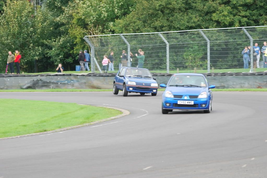

Had a blast. The 20 year old French engineering held up great.
One issue i seemed to have was lack of grip coming out of corners.
When i put the foot down at the end of a corner i was getting much traction. I'm pretty sure this was due to the suspension setup. I have stock suspension and there was noticeable roll.
I had pretty good tyres on the car so doubt that contributed too much.
What should i look at upgrading?
Check out the pics below:

Looks like it's riding fine to me! I guess it depends how many track days you are planning on doing and what compromises you want to keep it a good road car.

Agreed, bodyroll doesn't look that excessive to me.
Here's an example of excessive bodyroll;

woah that is a lot of bodyroll, I wasn't getting anything like that.
