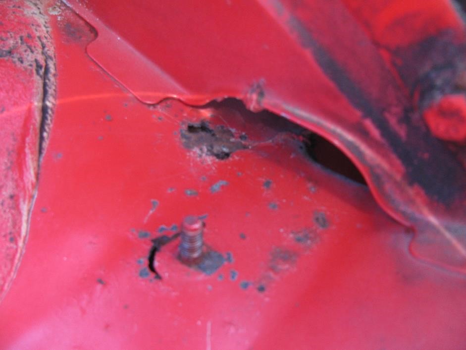

Same problem here took the scuttle away and small rust patch with a pinhole under the seal at bottom corner.
Looks like the seal has shrunk a bit there as sitting higher than on the other side.Hosepipe on the windscreen confirmed
this is the culprit! Have the car drying out now waiting for a slot to get sorted.

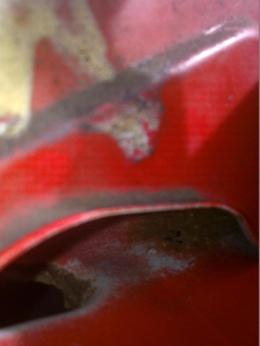

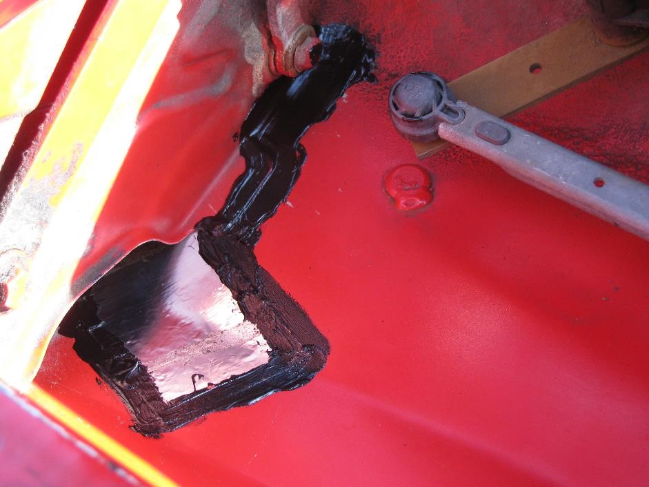

hi folks- if anybody searches and finds this thead- heres what is causing water in both my footwells:
Rust in the scuttle panel around both left and right drain holes- also inside the section behind the bonnet hinges.
My repair has consisted of some steel tape, sealant and a load of hammerite spayed into the area behind the hinges. Leak has stopped. Hope this helps someone.

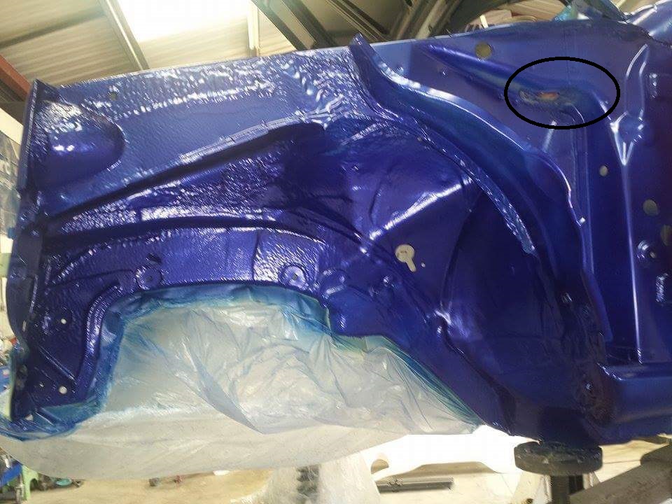

If you look at the picture attached I think the suspect area is just aft of the drain hole(circled)- it encompasses this 'box' section and the lower pan of the scuttle panel. My intention is to cut this area out and make it all good.
As soon as I have time its all getting done.
Oh sorry picture credit- Justin that's from your build post- hope you don't mind me pinching it!

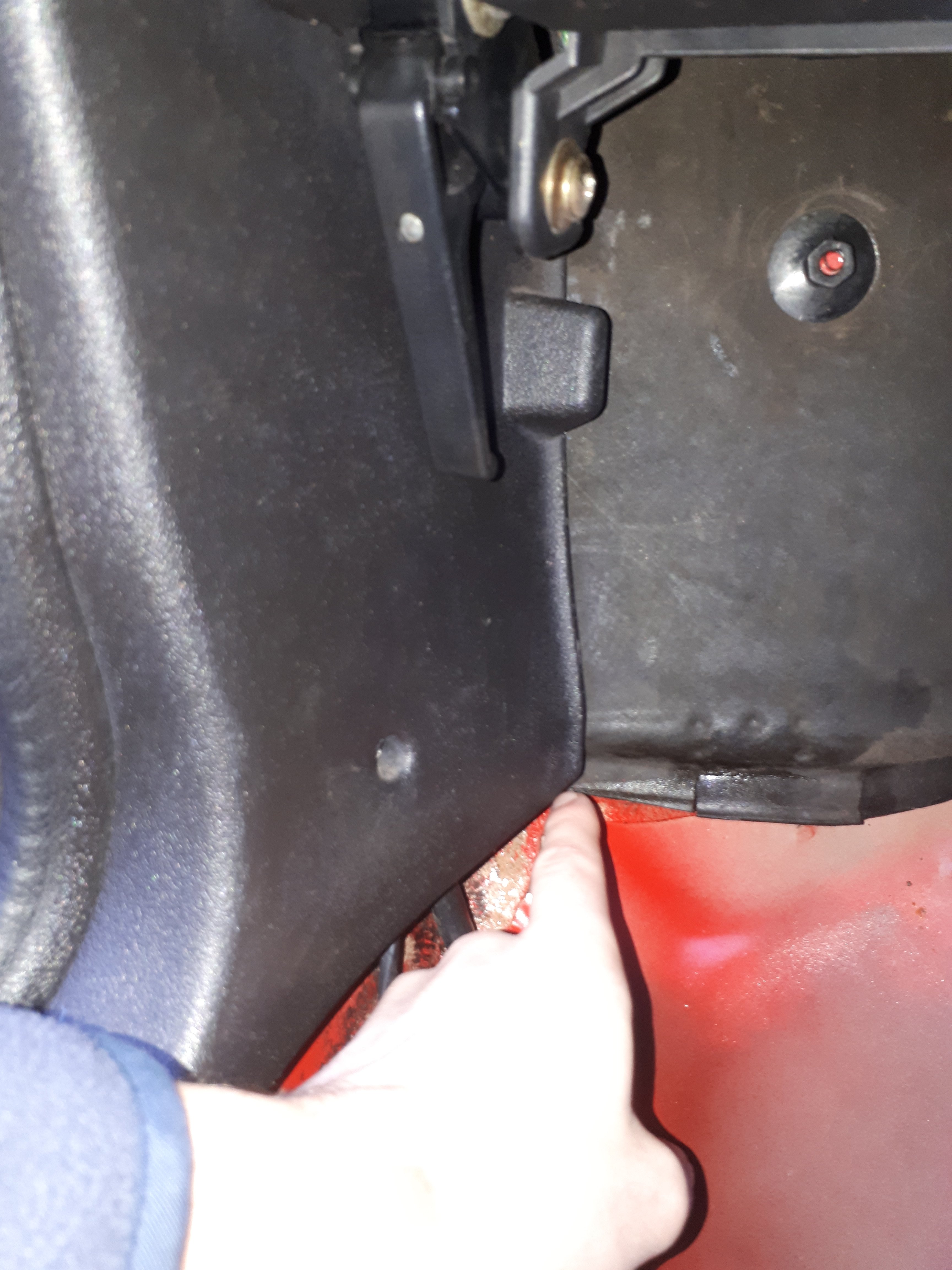

Got a fairly bad water leak and i've traced it to the corner of the passenger footwell, it's not the windscreen rubber and it's not where the bulkhead meets the floor in the engine bay also it's not from the top of the scuttle. It's seems it's coming from along the vertical sealant line. The soundproofing it the most wet in the corner by the kick trim and it's also wet along the bottom, it seems the water trickles down and along the sealant horizontally as well. Will I need yo remove the wing to sort this? I can't seem to remove the kick trim i can only get it so it moves i think the plugs are stopping it from pulling down any suggestions
Edited by Callum
steve@cornwall
bonnet release needs to be removed. screws go through the kick panel
If that's not coming from the scuttle panel I'd be amazed
