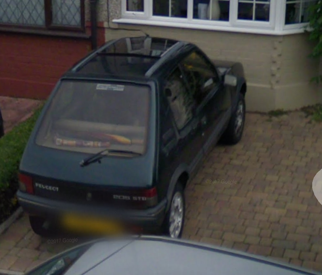

L860FVM
Hi @ryan_stdt,
I can't believe I found this forum post. My mum used to own L860 FVM, the last recorded date I can see of us owning it is from Google Maps Street View, back in September 2008. I know the plate is blurred out but it's definitely was hers, also see the rear window sticker. The person you bought it from was possibly my Dad! Would love to know what happened to it, whether you still own it or if you have sold it on or for parts. I can't find any info about it on DVLA.
Cannot wait to hear back from you.
Charles.
