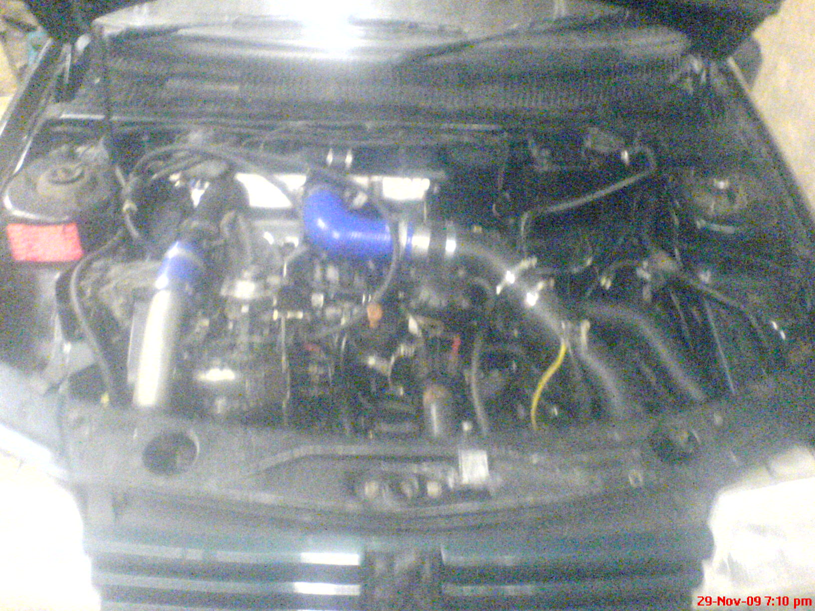

i ve been working nearly all weekend, with paul, to get the engine out of my donor 306 and get it ready to put in to the 205, and it is pretty much ready to go in.
all the coolant pipes are ready
headgasket changed
406/ xantia manifold fitted
new clutch
everthing has had a good clean
the one major problem that i have had is getting the clutch to work because im running a hdi gearbox (pull type) on a 306 td clutch (push type) with a 205 clutch cable.
i think i sorted it by conbining parts of the 305 clutch cable with the 205 clutch cable

i haven't got round to fitting a ream beam yet and im not sure abouts bias valves to be honest. i haven't driven mine yet to test the brakes because ive fitted 306 gti6 front brakes and a 406 M/C and im not sure what effect this will have on the rear brakes.
i haven't updated my progress for a while so here goes,
the engine is in and running BUT with one major problem, i cannot seem to select 5th and reverse gear on the HDI gearbox. the gear linkages dont seem to be obstructed in any way.
Im not sure if this would effect anything but in order for the linkages to fit on the gearbox i needed to swop one of the gear arms on the gearbox from the 205 gearbox, could i have dislogded something in the gearbox??

we've solved the gearbox problem, it turned out to be something simple, the gearbox arm wasn't aligned properly. cheers paul :)
all i need now is a new coolant intake block, drop links and a fuel line and she will be ready for the road (when i have enough money to insure it)

the pump i used had sometype of chip that was wired to the solenoid that was enbedded in a rubber case. i had to remove the case, with a hammer and screw driver, to get to the solenoid. to wire it up all you need to do is to connect an ignition live to it ,and bobs your uncle.
finally the car is on the road now, all i have left to do now is lowering it a little, making the rev gauge and giving it a tune.

not a happy up date unfortunly, i think my turbo has seen better days as it is blowing alot of oil out of the exhaust. this is what happens when you 2 bar boost pressure thought a high milage turbo.

ryan_stdt
the steering fine, a little heavy when stationary but i like im now in control of the car now plus there less to go wrong lol
yeah i would recommend the conversion and defo the HDI gearbox.
the only hick ups that i faced was
the clutch cable - i had to combine parts of 306 cable with the 205 cable
ryan_stdt
the steering fine, a little heavy when stationary but ifeel like im now in control of the car now plus there less to go wrong lol
yeah keep it diesel i would recommend the conversion and defo the HDI gearbox, ive never been in a 205 with the 2.1 lump in but im sure its torquey
the only things that i faced were
swoped over the on over the gearbox arms
im running gti-6 brakes so i needed 1.9 gti hubs and driveshafts
the turbos are angled slightly different but i used a new down pipe gasket and it does seem to weak
other than those it was fairly simple to do
as well as my turbo failing i think that my H/G is going (even tho it only done under 2k) as ive got i bit of mayo under the oil cap and the coolant sometimes has a few little bubbles in - ive got a week off from wednesday so hopefully it lasts til then
