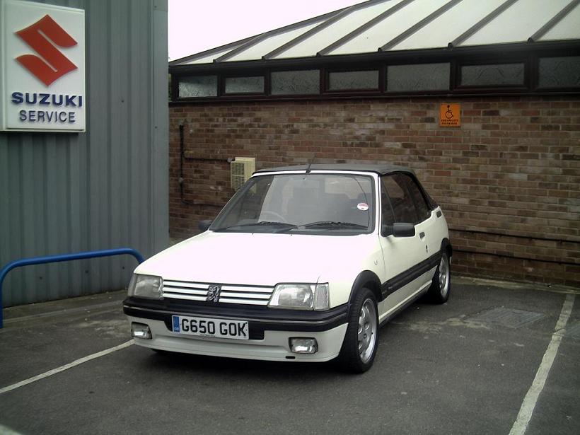

dan_cole69 0 Posted January 12, 2009 (edited) Hi, ok where to begin. about three months ago i bought a peugeot 205 cj from a friend of mine who didnt have the time or the enthusiasm to carry on with the car. The car was in pretty good nic and there was just a few niggly bits that i wanted to sort out. I finished the bits and everything was fine i was getting ready to put it away for winter when i was given a 205 GTI engine from someone i used to be friends with. . I know what your thinking "why is that such a bad thing" but it opened a whole big can of worms. So as you can guess i decided to attemped to but the engine in the 205 but not untill i had given it a novice refurbish. lol. (i will be opening another thread soon on how i got on). Everything was fine i have had the engine apart and now it is almost back together, just waiting on a few bits witch i will be getting soon. but my problem is the more i read the harder i believe it is going to be. i know i have to change the subframe and driveshafts thats not the problem, its that i have to wire in a ecu (i haven't got a clue how to do it) and i think i have to change the fuel tank for the pump and everything along with the fuel lines. Am i wright and is there anymore things i should know before i commit myself by taking the engine out? and my final question is am i being stupid for doing it? opinions and answers will be greatly appreciated ( because im about at my wits end) Thank Dan Edited January 12, 2009 by dan_cole69 Share this post Link to post Share on other sites
