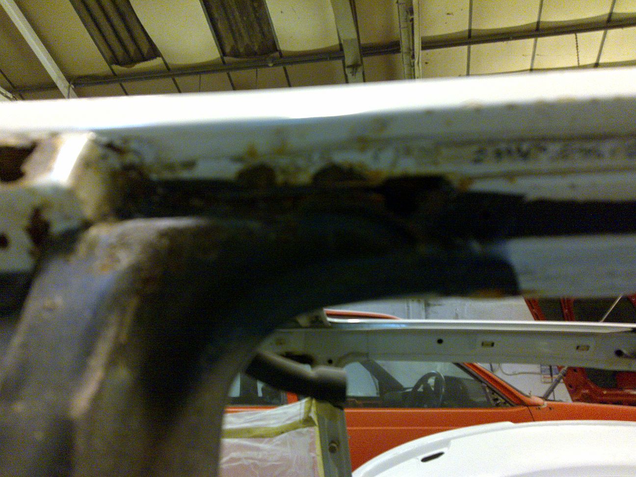

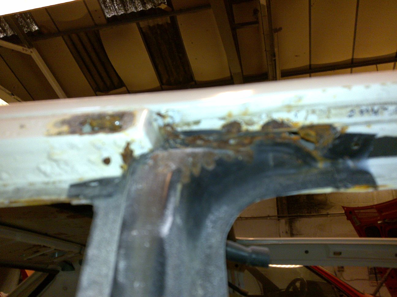

As promised, pics of the offending section.
Not the best pics. But should give a general idea. I didnt realise it had gone along towards the A pillar too. Its been picked at to reveal, didnt look quite so bad before it went in :P
Theres another hole the other end of the quarter window too. And a lot of the stuff that hasnt been prodded on the underside of that piece will go through i guess too.
My own fault for leaving it.

thats easy repairable i spent last night plating the inside of my mates passenger door where the hinges go took about 1hr but when its done youl never know,theres not a mark on the outside of the door just the inside fronts rotton,,,,,,did you cut a replacement piece off another car or is he just gona fabricate a new bit with some steel
Rom
Im getting another bit cut off.
He said he could do it, and would if it was something rare, and unable to replace. But he said its not worth it if i can get a replacement.
Looking at it myself, it does look a job. Youd have to fabricate that whoel section, and it has so many different edges and curves.

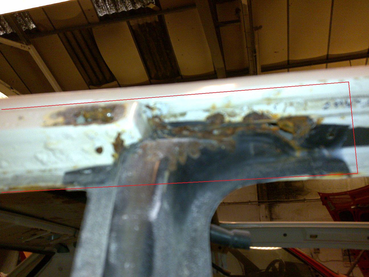

From looking at the pictures, would have thought he could repair it without to much trouble.
Sure he could fabricate something to strengthen it, if it is more structural than it appears.
Rom
I dont know enough about bodywork, just what he said.
From what i saw, he would have to make a pretty big section, ive highlighted what it looked like to me, it would go right they way back to the c pillar, as theres holes all the way down.
In a way, i think id be happier with a new panel. Theres a lot of curves, and edges etc to get perfectly right.
