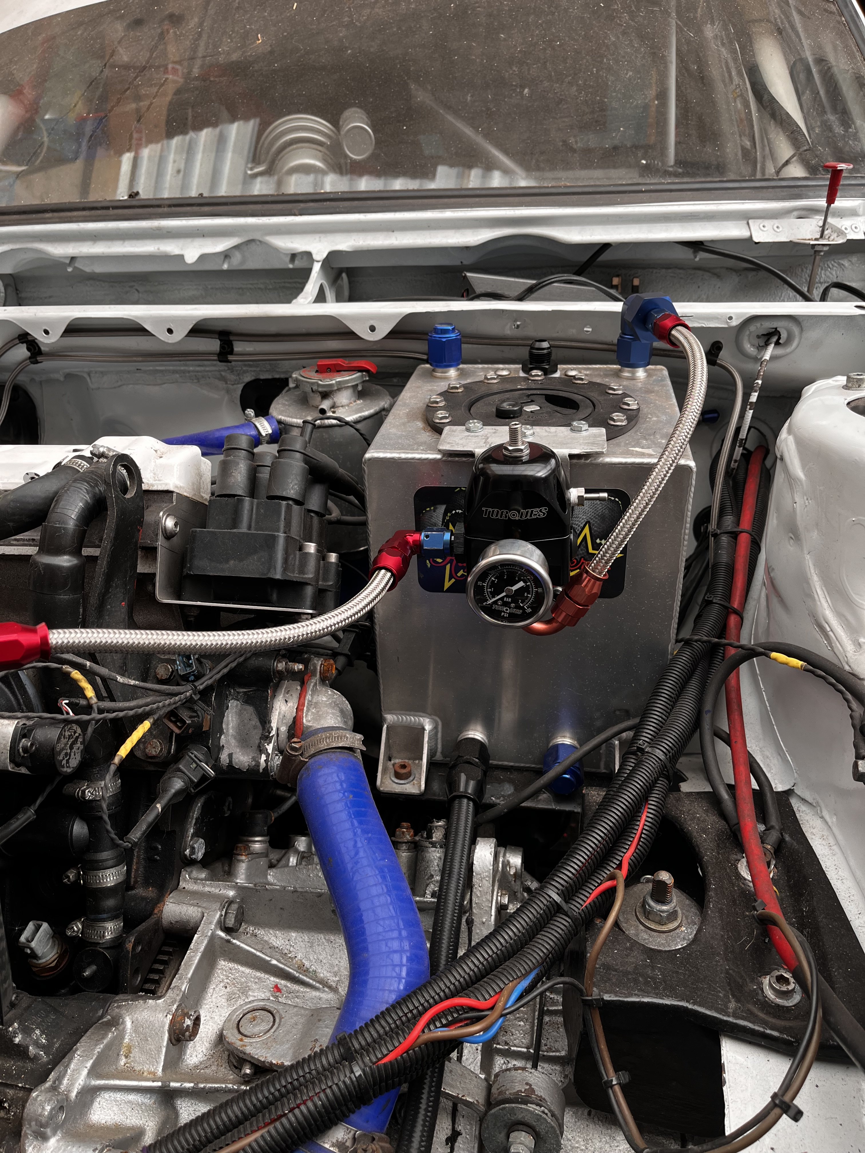

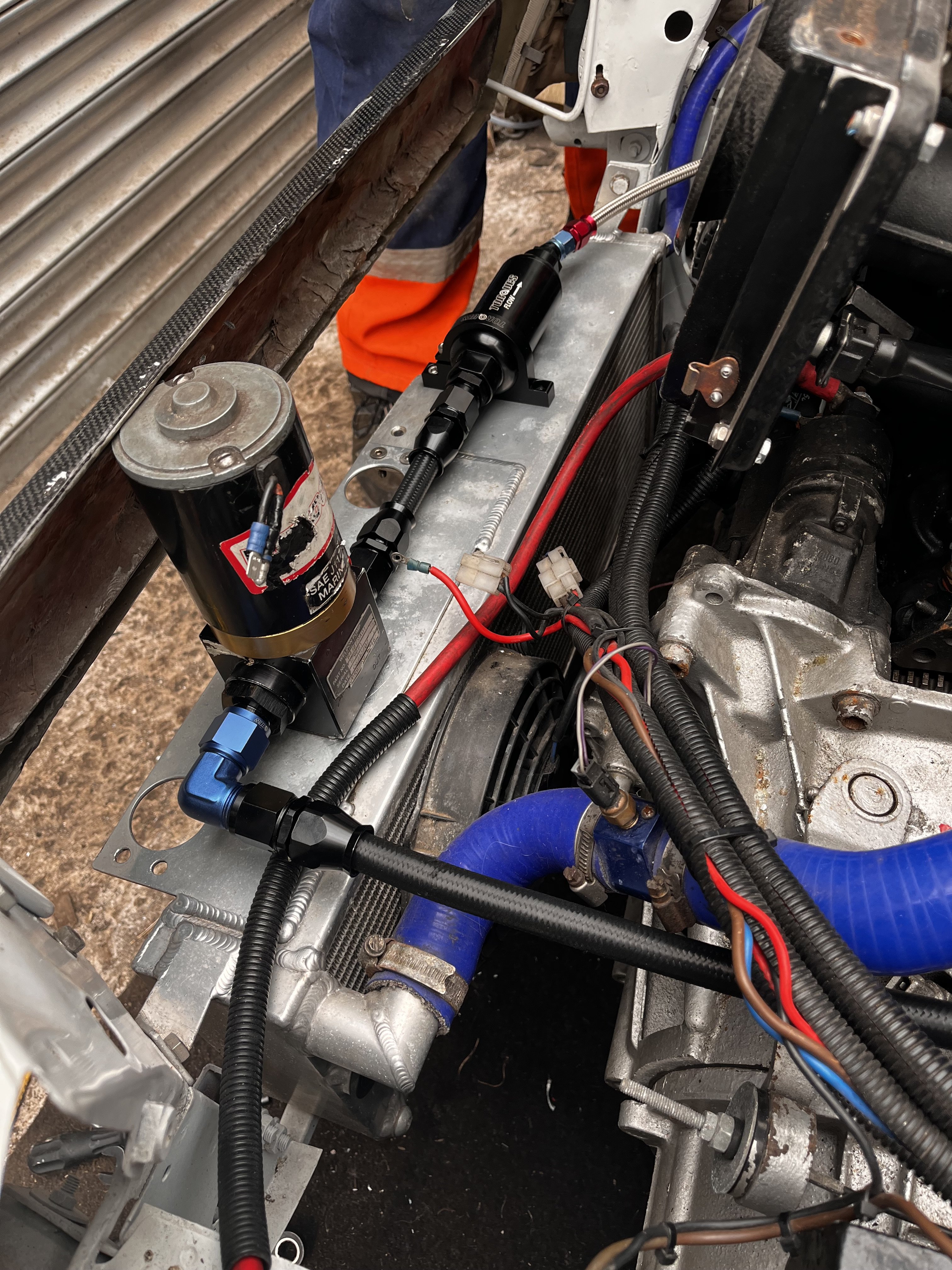

Just a brief update, i decided to ditch the gearbox ideas for now. The current plan in true Jeremy clarkson fashion “ more powwwwwer”

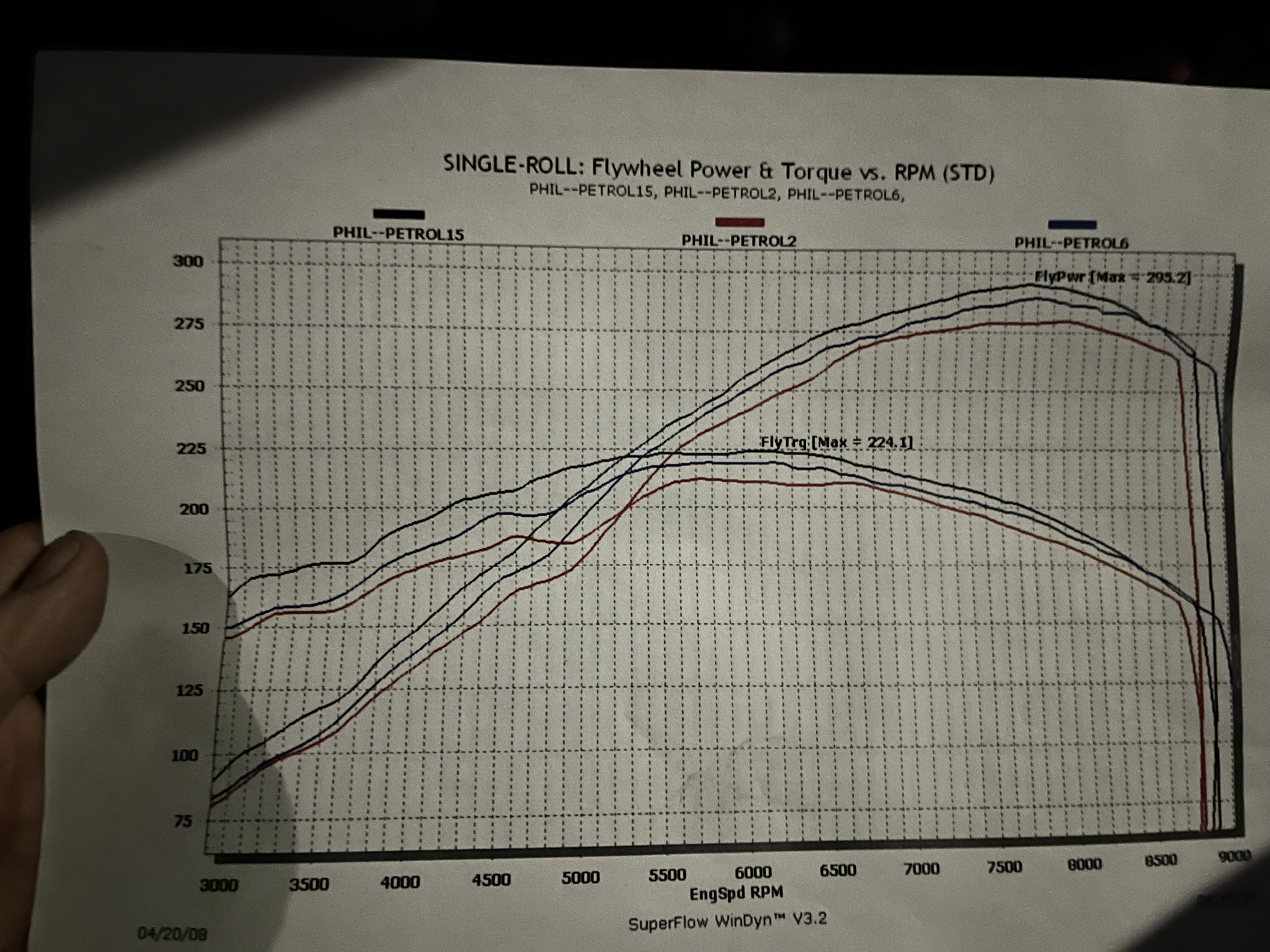

im going to be running new fuel in the form of nitro rc car fuel. 25% nitro. I’ve upgraded all my fuel system so it can run alcohol based fuels, fitted a large fuel pump ( Weldon). 900 cc injectors and bought some ngk 7 and 8 spark plugs to see which ones it likes.  Dyno day will be booked soon to see what it makes.
Any guesses to what power it might produce??  I’m hoping it’s in the 340 to 350 range which should( if the transmission holds it) see me into the 10’s.  I’ve had a new logo made too which I think is pretty cool. I’ll post that below.  I will update after the dyno day.
