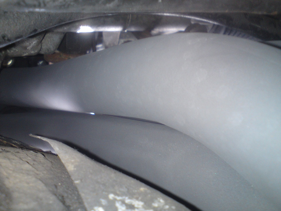

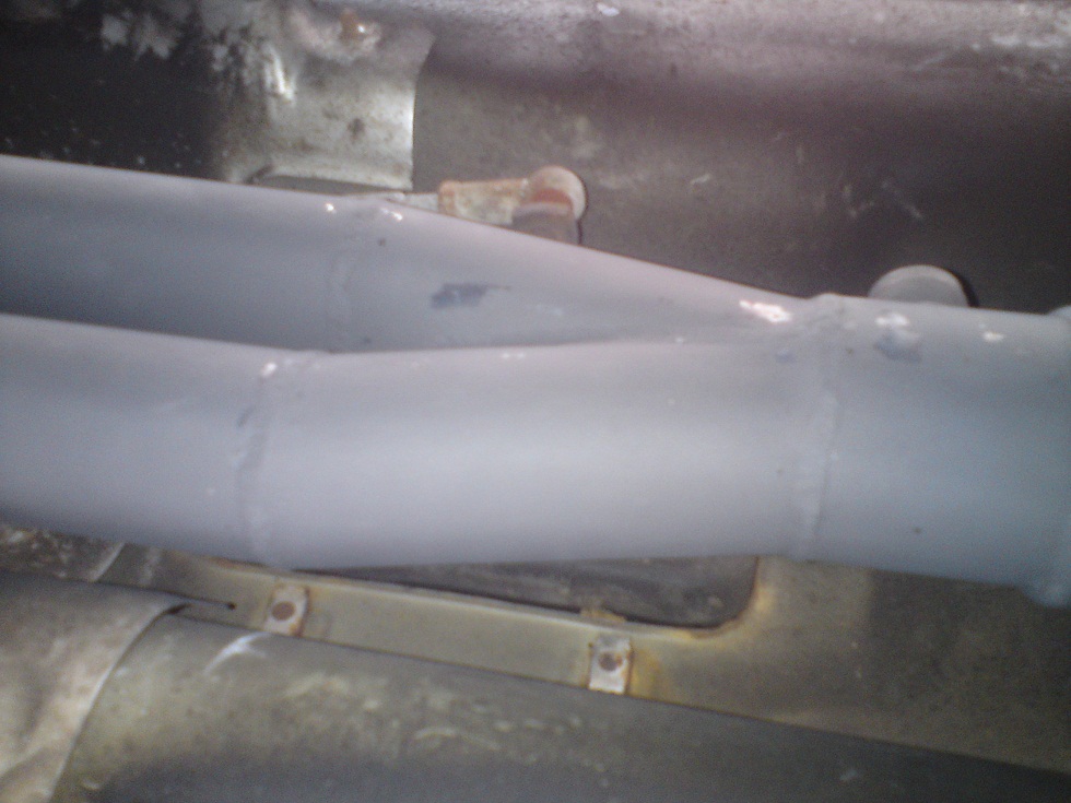

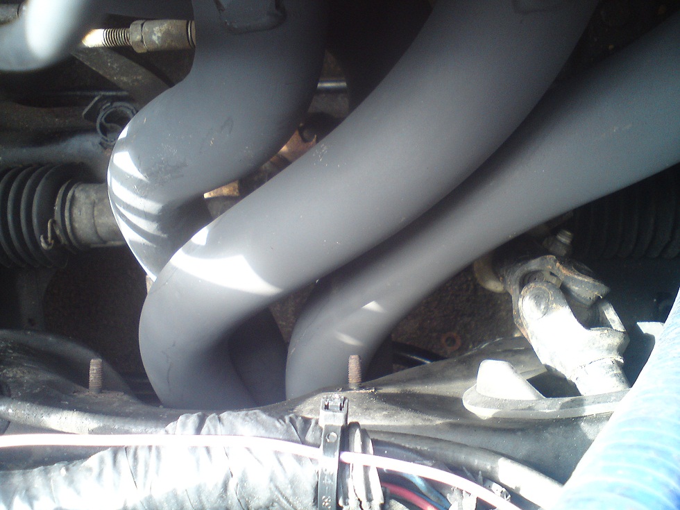

pip470 61 Posted July 23, 2010 Ok so its hard to get decent pictures but I think you get the Idea. Share this post Link to post Share on other sites
welshpug 1,683 Posted July 23, 2010 nice, that's a decent length secondary pipes, dare I ask how much it set you back? Share this post Link to post Share on other sites
pip470 61 Posted July 23, 2010 Not cheap but I am happy with it. Share this post Link to post Share on other sites
