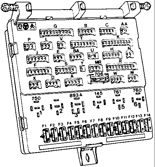

I know the front wiper relay in ph1 cars is found near the steering column. But in ph2 dashboard wiring, the wires run directly to the fuseboard.
This leads me to believe that the ph2 wiring harness uses a wash/wipe relay located on the fuseboard itself. So my question is, where is the relay found on the fuseboard: 1,2,3,4,5 or 6? (see picture below).
And can I move the ph1 front wiper relay located near the steering column and plug it into the fuseboard at this location? Or will I have to get a specific wiper relay for the fuseboard?

Its no 3 and its a blue one

My relay in no. 3 is black. Is there anyway to tell from markings on the relay what it is for? I assume each relay only fits one particular spot.

Some are black say if its been replaced, when you remove the relay the intermittent wipe will stop work, or you can check by holding the relay and feel it operate.

Thanks. Guess I'll know when the electrician is finished checking the looms out.
