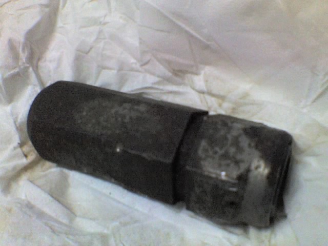

humanz 3 Posted November 1, 2008 Ok, so based on the picture, which end is the input, that is, which end is connected to the master cylinder? Thanks. Share this post Link to post Share on other sites
timmsy19 3 Posted November 1, 2008 Ok, so based on the picture, which end is the input, that is, which end is connected to the master cylinder? Thanks. iirc the right hard part(on the picture) goes on the outside of the car Share this post Link to post Share on other sites
jord294 87 Posted November 1, 2008 the brake pipes have different sized unions m10 x 1 and m12 x 1 the larger size end should be m/c side Share this post Link to post Share on other sites
humanz 3 Posted November 1, 2008 the brake pipes have different sized unions m10 x 1 and m12 x 1 the larger size end should be m/c side Gotcha. Thanks. Share this post Link to post Share on other sites
