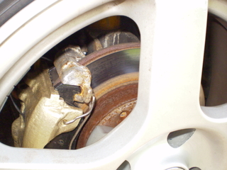

mogsman 2 Posted October 27, 2008 Hi all, since putting ate calipers and pads on I have some uneven wear on the outside faces of both discs but the inside faces are ok. Any ideas? Ian Share this post Link to post Share on other sites
mogsman 2 Posted October 28, 2008 Fixed the problem. There was a build up of rust on the inside edge of the caliper so the pad wouldn't sit flush. All should be well now. Ian Share this post Link to post Share on other sites
