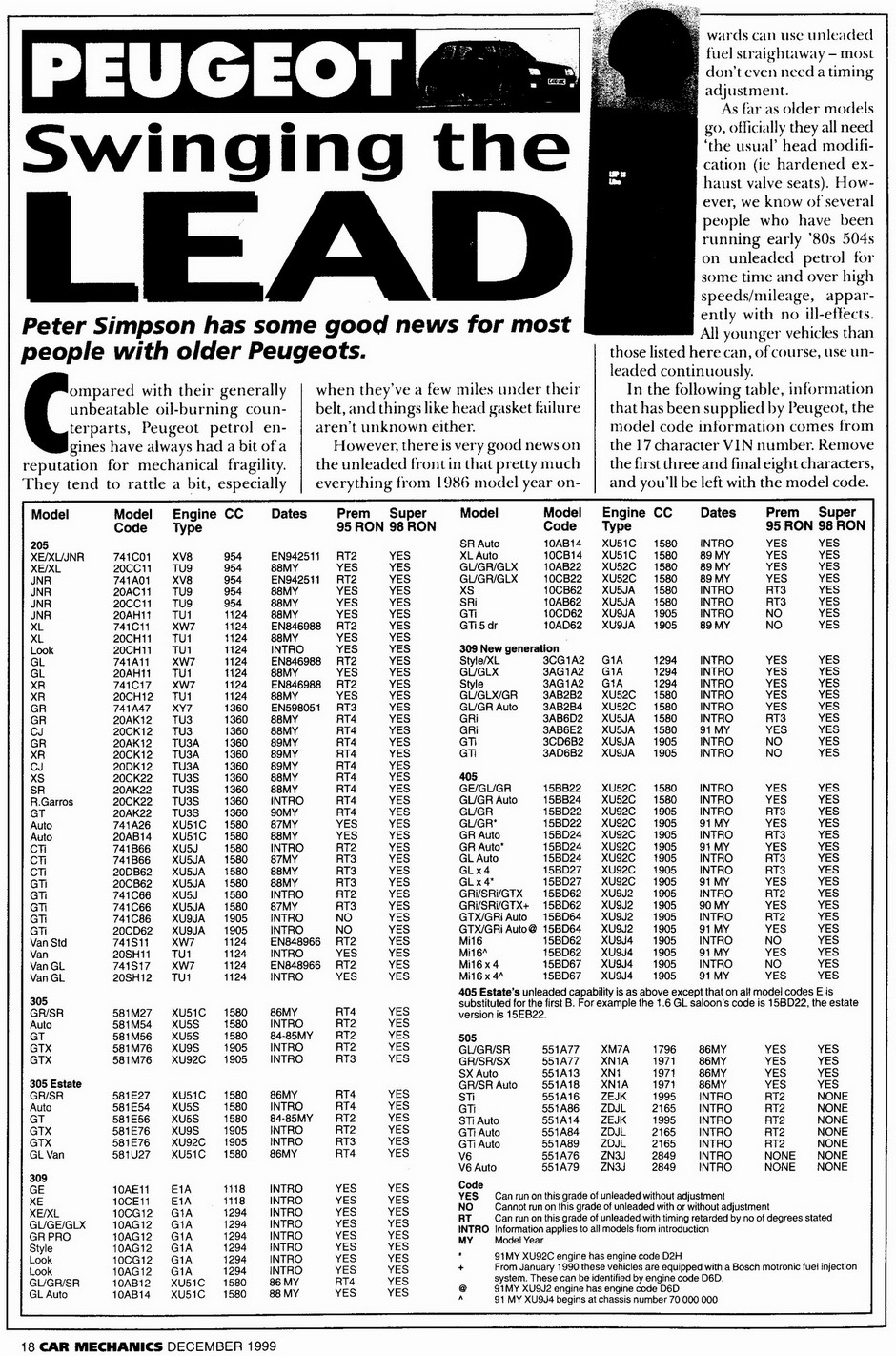

The handbook for the Mi16 (certainly the earlier ones with the 2-row ECU anyway) says that super unleaded is required. The later ones with a knock sensor can run in 95ron.
Whether the handbook is right or not varies from one engine to another. Some run fine on 95ron, some don't.

Should be run on super. They will run on 95 but tend to get very sooty and dirty inside.

Yeh the Handbook, Haynes and Autodata all say 97 RON. Mine feelss less urgent at high RPM on 95 RON and is also slightly less economical.

The 405 Mi16s before chassis number 70000000 are supposed to run on 98 octane 4 star or super unleaded. Those after (approx. 1991 H reg) drink any old s*ite thanks to the knock sensor. Definately sounds better on a bit of V power or that 99 ron junk that Tesco sell.

No, but 4 star is the equivalent high octane fuel. Normal 95 RON unleaded isn't as high octane as four star was. A car that could only run on 4 star (205 GTI 1.9 for example) can only run on super unleaded these days. 4 star was something like 98 or 99 RON.

If you don't have a knock sensor and the engine has been set up to run on 95 you will see no benefit in running 97+ because the engine cannot adapt to the fuel by advancing the timing. But in the case of the 205 engine it has to be set up to run on 97 and you will see a detriment in performance if you run it on 95 - theoretically you should see knock because the timing cannot retard automatically.

It all depends on how the timing is set. If you advance the timing to book figures then they will pink at high load/low revs on 95RON Unleaded, however if you knock the timing back a bit they will not pink, at the expense of a "little" power loss. My 205 1600 8v gets 95RON as most of the time it doesn't get driven hard enough to tell the difference due to traffic conditions.

Thing is, at least in the case of the earlier Mi16s that didn't have a knock sensor, they seem to tolerate 95 ron unleaded. But the timing was set for 4 star and that was either 97 or 98 ron, so in theory you really oughta be using super unleaded.
The 1600 loses much less than the 1900, even Peugeot say the 1.6 can be modified (ign. retarded) for 95 but not the 1.9 even though its possible as the power loss is so big.
