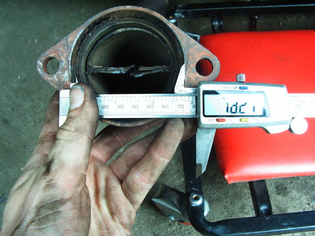

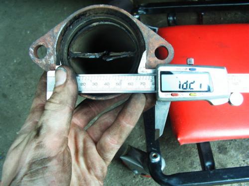

welshpug 1,682 Posted September 25, 2008 can only find one fitting kit for the RFY engine! here's a picture of an S16 downpipe (one of my own spares) which shows how much bigger the flange is 5mm odd,. enough! also, the spacing of the bolt holes is different original Phase 1 downpipe - S16 Downpipe again, 5mm in it, the flange is also 5mm deeper. the pipe that fit in the end , i.e the downpipe itself, is the same size, 65mm O.D. Share this post Link to post Share on other sites
