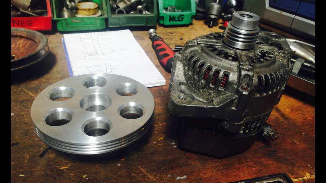

sorted out the alternator pulley situation so it charged properly was the first job

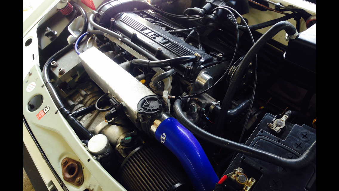

Then I made up a catch tank that fitted on the jack mount and tidied up the breather set up.
In a bid to quieten it down and aid off throttle driving I also fitted a second throttle body on the inlet of the charger. This made a huge difference to driveability, massive improvement in all driving situations, no need for a huge blow off valve and it quietened it down (a bit)
