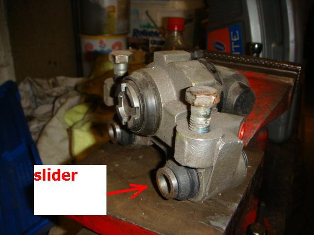

something doesnt sound right? these bolts are usually locktighted meaning they usually arent rusty. i've never seen any that wont go all the way . are these the bolts that go through the sliders? have you checked how far they go through the slider when off the car ? have fitted the strengthening bar between the two bolts ?

not sure what you mean by sliders... but they just go directly through the caliper and into a hole on the arm. it appears they could go through to the disc if you screwed far enough

hmmm.. is that a 1.9 gti caliper?
could be missing those sliders but don't think i ever had them
will have to check tomorrow - memory failing me
Pugnut
yes ,thats 1.9 gti rear calipers. the pad carrier isn't attached which could be throwing you.
