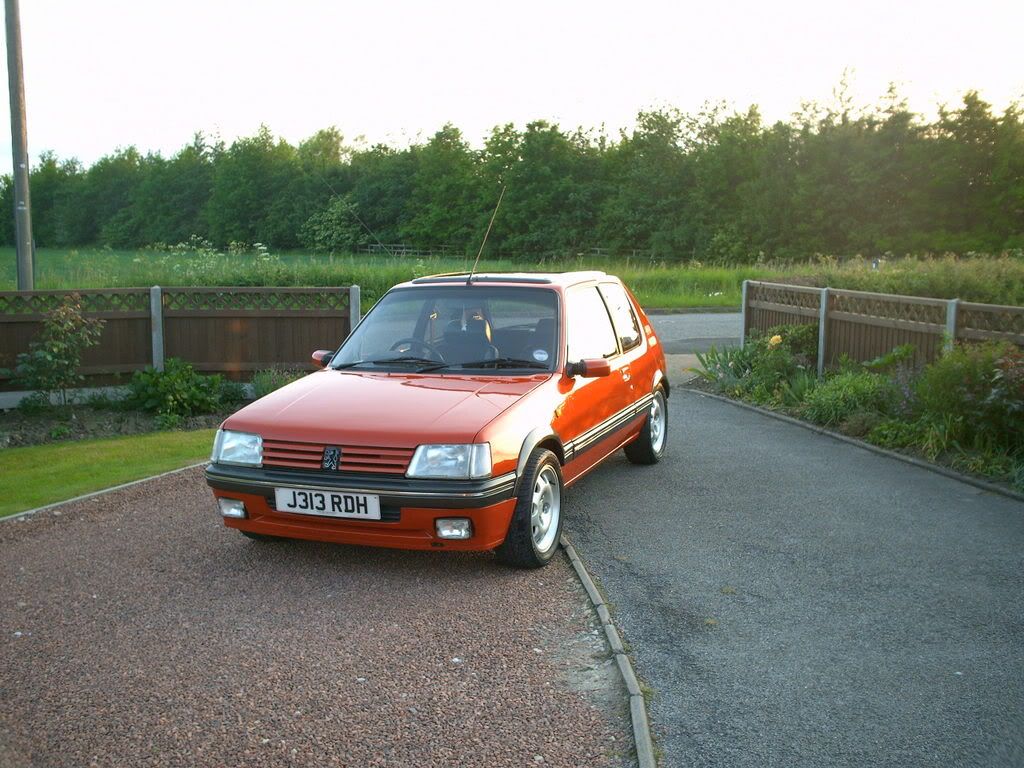

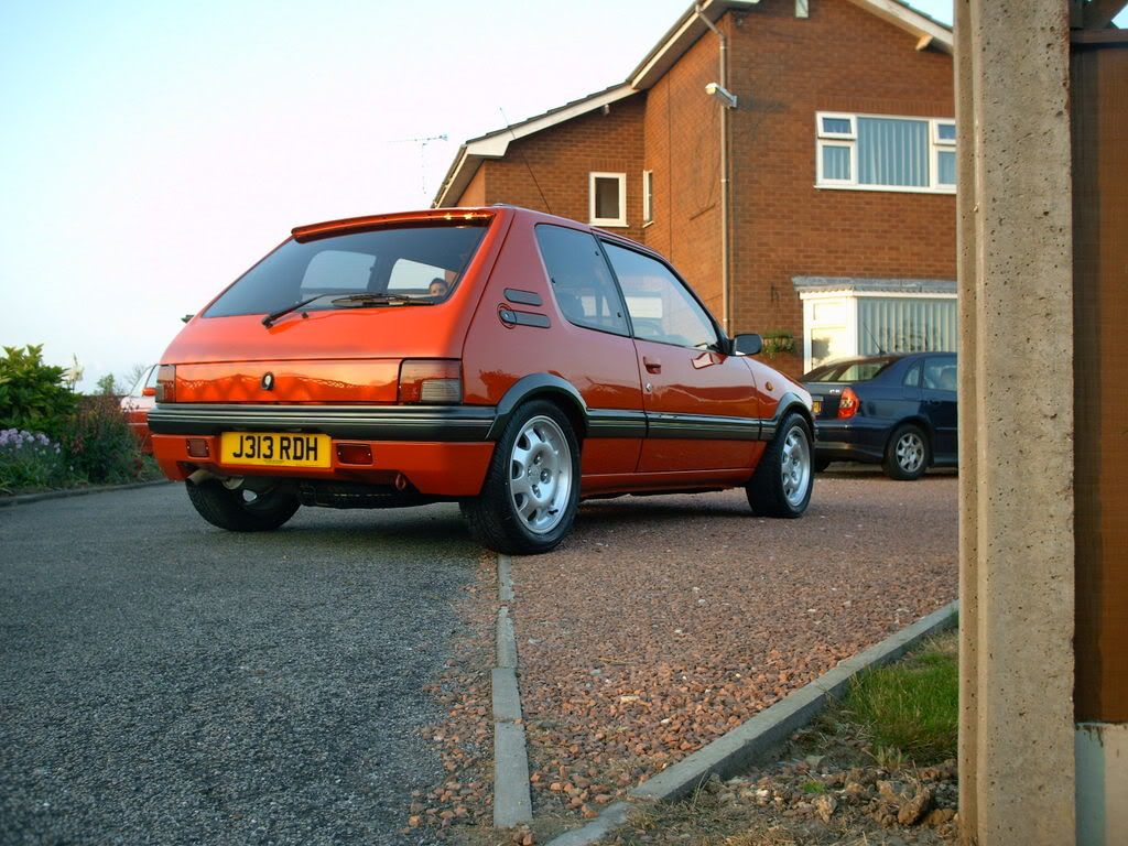

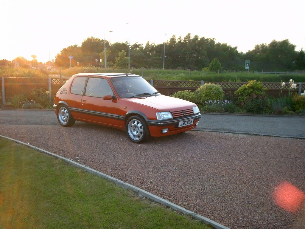

well as im new on here i thought i would introduce all to my car and show you its current condition
this is the car when i was using last year
http://i180.photobucket.com/albums/x73/big...redcleaned1.jpg
http://i180.photobucket.com/albums/x73/big...redcleaned5.jpg
http://i180.photobucket.com/albums/x73/big...redcleaned2.jpg
then at the start of january the oil pump went on it and knackered the crank
and its pretty much sat there like that since. progress has been slow as i moved out with my girlfriend and in march my workplace burnt down :lol:
but i am getting back on with it now got all my bits just gotta put it back together!!
will get some more pics when i can
let me know what you think
