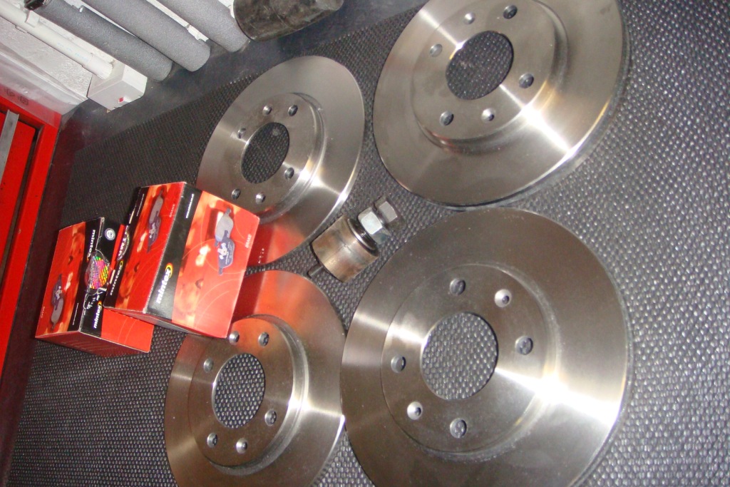

With the mot approaching and all 4 disks looking pretty ropey , handbrake almost non existent and a distinct lack of brake dust on the rear n/s wheel means i've dug deep and parted with a few beer tokens.
this weekend i shall mostly be under a 205.
i want standard ride height which the front is already, but the rear sits too low. I dont think its ever been lowered, just sagged a bit over the last 2 decades. With Tom's torsion bar extraction tool in hand i'm going to reset height and probably drop a new set of bearings and seals into the beam too.
Its a standard car and staying that way , so bog standard disks and pads all round, strip and clean all 4 calipers and possibly a lick of paint. new brake fluid and a general look around for possible mot fail points. I didnt do the brakes last year and the discs didnt look great then, but pretty much replaced most of the front suspension so that shouldnt be too bad.

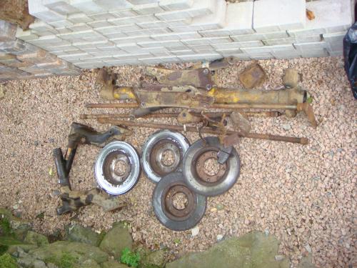

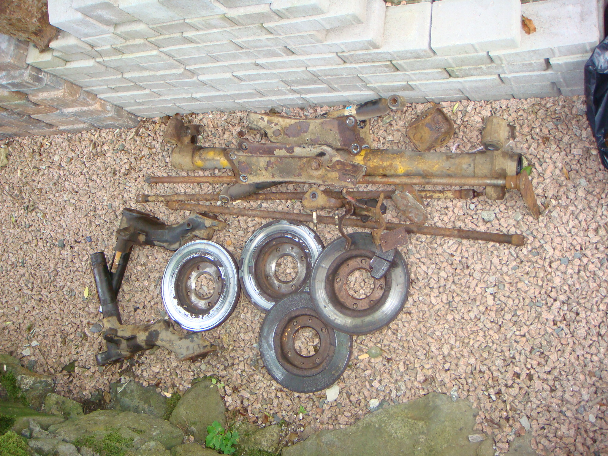

well the good news so far is that Toms torsion bar tool works a treat, very impressive and worth every penny. The bad news is that the rear beam is gone. Not just a little bit, both sides completely eaten away including the tube. didn't see that one coming! camber looked fine too. :(

pile of resulting scrap! (look at the condition of the inside of the old front disks :P )

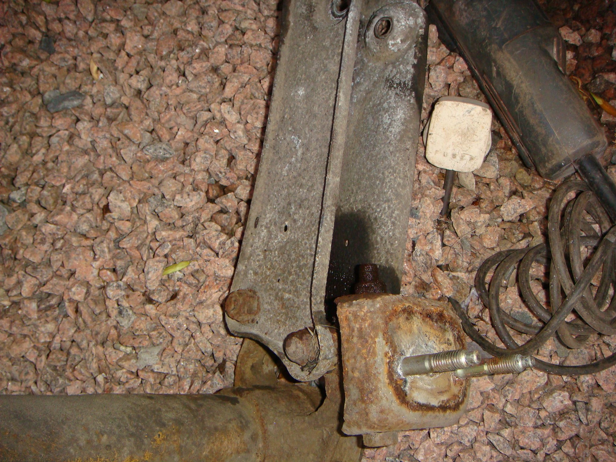

bit late now but those front brackets from the beam to the body are offset on a 1.9, they place the beam further forward than the 1.6 ones, the 1.9 Tyres are slightly bigger overall and may rub on the bumper on 1.9 brackets.
Pugnut
Good work getting it don in a weekend!
yes i noticed that and swapped the 1.9 brackets onto the 1.6 beam, didn't know the reason though. i also put the original stays to the rear mounts onto the new beam as the 1.6 ones were pretty rotten
so the 1.9 must have a shorter wheelbase then?
cheers, Al
Pugnut
heres the 1.9 ones that came off and went onto the other beam .
You sure you dont mean the 1.9 beam is further back to clear the front of the arch?
