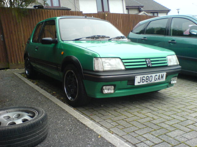

One down - three (four?) to go!!!

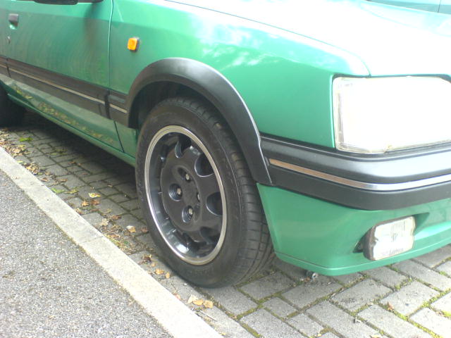

About 5 hrs. / rim :)
This is why I wanted to do them (2 down, now :) )

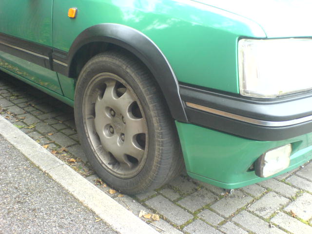

Anyone thinking of doing these, carefully applied paintstripper saves tons of time, and varying grades of steel wool instead of wet and dry is tons better. Much of what looks like kerbing doesn't actually go through the paint to the rim, and light kerbing is much easier to deal with than a little corrosion, when choosing wheels to start with.
1 to go :blush:

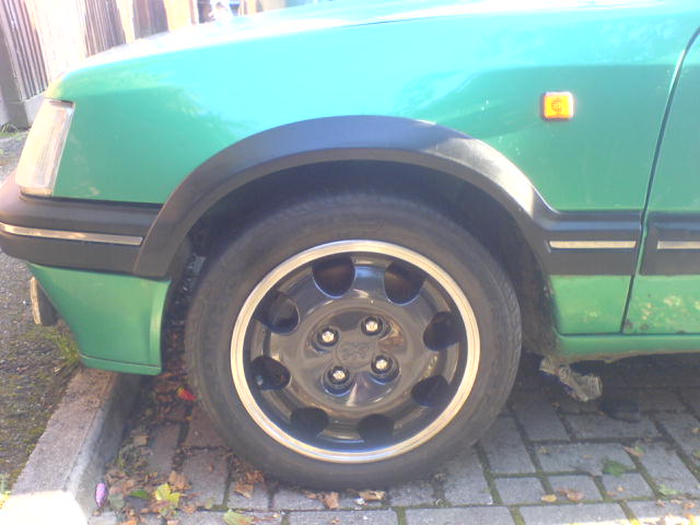

Well, four rims now done!!! Last one was SMR, so will be the spare when I do no4 Speedline :P I've always been a bit unsure of the goodwood wheel look, but here , I :) :) it.
I've gone with advice and left the lips un-laquered (and bought a bigger tube of metal polish) which also means I can continue to work on some areas where the sanding marks are still evident close up. All in all, I'm VERY pleased - lots of effort but little cash outlay! my kind of job :)
Reckon it's an improvement?
