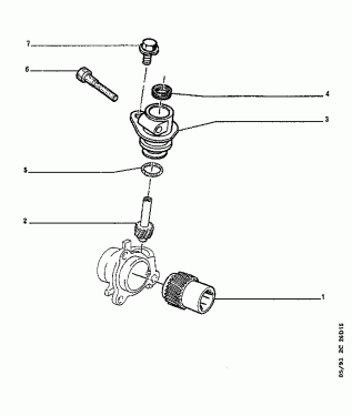

I'm presuming that I need to change the bit that fits around the driveshaft?
Is it part #1 on this picture that I need?
Edited by Grim.Badger
When does the gear spin the drive?
If it turns without the driveshaft or diff turning then something isn't right.
#1 turns with the diff / drivesshat & spins #2 when it does which turns the cable.
Take the bit out of the gearbox (#3) where the cable fits into & see if you find anything broken.
IMO #2 is more likely to be broken because #1 is a sleeve over the driveshaft so difficult to break so it'll be an unknown until you strip it down.

I have taken number 3 out and all seems to be fine, number 2 seems to have a concavity to the splines but does turn the square drive bit.
I don't understand how number 1 turns number 2, is there another cog in there somewhere as they don't seem to match up :blush:

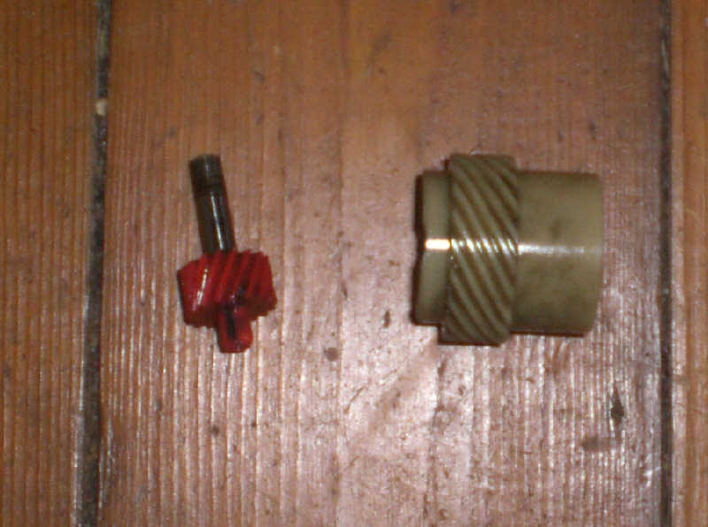

See attached picture, there are teeth on #1 that mesh with #2 to drive it.

I've just double checked the pinion and it is worn quite badly, so I've just ordered another. It has 17 splines so I have ordered 2649 11 01 CONTROL PINION
17 DTS for just over £5 from Peugeot :blush:
