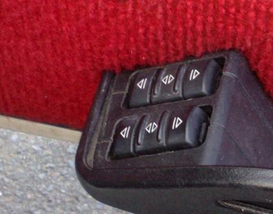

pete1986
...Renault 19 window switches :blink:
Allows window to fully close/open with one button press. Ideal if your lazy like me!! Pins are exactly the same, you just have to cut a bit of plastic off for them to fit.
Im starting to wonder if theres actually a single 205 made of 100% 205 parts :rolleyes:

what..... thats ace, so if i get someof them buttons for my windows, it would make mine go up with one click... or would i need a ecu, if so whats the ecu look like for the window system?
pete1986
No need to change any wiring or ecu, a straight swap. As i mentioned above, there is just a bit of plastic on the back of the R19 switches surrounding the pins to cut off. Simple as that :ph34r:

I don't get how these Renault ones work with no extra control module? How come Peugeot and Citroen one touch switches need a separate control unit, which in the case of the older ones (BX for example) is bloody bulky (!), yet these Renault ones, which are not even modern, manage to have the same functionality without any extra control unit or wiring? Something just doesn't seem right here :rolleyes:
Don't get me wrong, I'm not calling the OP a liar or a bit stupid B) but I just don't get how it works and would like an explanation.
number2301
Some form of two stage switch? It couldn't be that hard to make a switch like that could it?
tagy
I am also surprised these are so neat compared to peugeot's version?
I have the Peugeot ones in my car, big bulky box, with relays and chips. I just wonder if they work as well.. will they stop if something is in the way? or a they just on a timer?
C_W
They use trip/relay switches to cut the motor I think so when it goes all the way up or all the way down the motor trips and doesn't try and move it more. It is strange that just changing a switch can create one-touch down/up.
