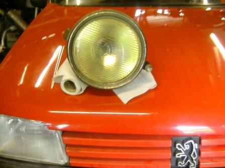

sutol
Might need to alter the bonnet a bit to get these in but they are BRIGHT :rolleyes:

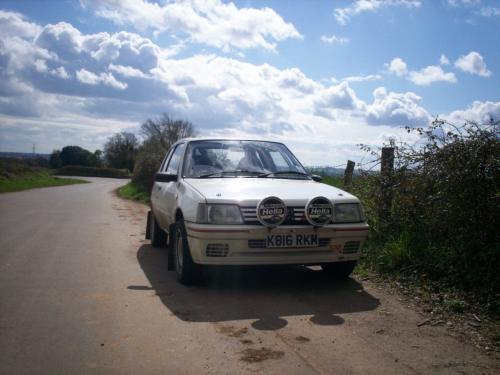

timb1046
thought i'd show you what they turned out like :)
they are central just the angle of photo makes them look a bit out.
All Praise The GTI
that cars too clean to rally! :)

timb1046
yeah road rallys, im not worried about ditching the lowers, the new grill ones are soo much better! the lower ones tend to pick up knocks pretty easily too, this is the second set in about 9 months due to damage. ive got the lights wired so they come on with the main beam but i have a switch enabling me to have them so they dont come on at all.

Car looks excellent, very clean. Just as an aside, my spares car is (was) H696 YYE :)
Where have you mounted your lights, Timmy? Crossmember, bumper or elsewhere? How steady are they? I have a similar set I was planning to fit at some point.

timb1046
i fitted them through the bumper which is very sturdy, the only problem i had was with the angle of them as they have several "clicks" of adjustment. however, there is no "click" that is just right so i stuck a small rubber strip under the front side of the mounting bracket lifting it to vertical (which the bumper is not) so now i have perfect allignment. ;)
