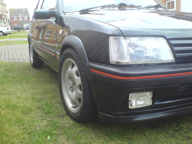

5150maxie 0 Posted April 17, 2008 (edited) where do you measure to get the ride height settings from standard to determing what i have now? i think they were 50mm springs but i cant remember? i am lowering there rear from standard height to suit the front. in this pic its my old beam height which was too low. Edited April 17, 2008 by 5150maxie Share this post Link to post Share on other sites
AdamP 0 Posted April 17, 2008 Get someone to measure from the centre of the wheel to the arch on their standard one, and compare it to the same measurement on yours Share this post Link to post Share on other sites
5150maxie 0 Posted April 17, 2008 (edited) Get someone to measure from the centre of the wheel to the arch on their standard one, and compare it to the same measurement on yours any one help with the measurements? mine is 30.5cm from centre of hub cap to arch and 58cm from ground to arch.what measurements will i need for the rear? Edited April 17, 2008 by 5150maxie Share this post Link to post Share on other sites

huckleberry 0 Posted April 19, 2008 Judging from the pics I'd say about as low front end as mine and I use -50mm Merwede springs on my Yellow Koni's. Share this post Link to post Share on other sites
