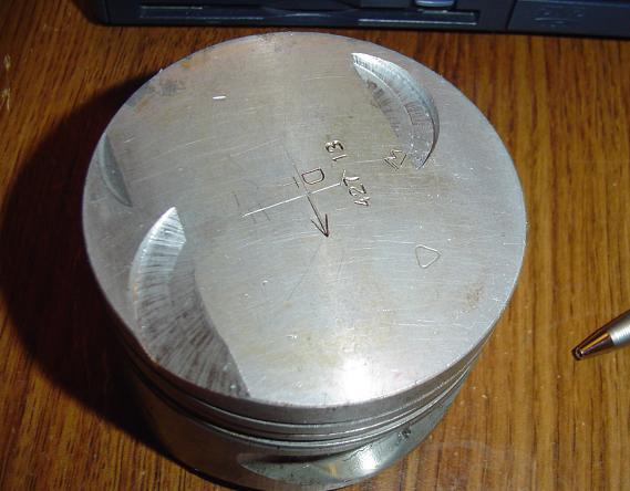

Sandy 189 Posted April 16, 2008 Here's the machined TU5J4 piston: I don't have a pic of the valve cutter handy. Share this post Link to post Share on other sites
christopher 5 1 Cars Posted April 16, 2008 Here's the machined TU5J4 piston: I don't have a pic of the valve cutter handy. Thanks that makes it a bit clearer. That looks quite a lot to shave off with the valve cutter method. What kind of lift @TDC where you using and valve piston clearance? Share this post Link to post Share on other sites
eeyore 0 Posted April 16, 2008 Sandy did those with an end cutter on the mill. I think that one allowed about 3.5mm plus clearance safely at TDC. Share this post Link to post Share on other sites
