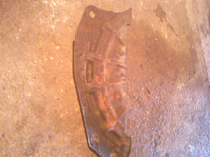

Atari Boy 11 Posted April 14, 2008 I have a couple of flywheel cover plates if it helps; they do vary in size btw, but go on after the gearbox is fitted to the engine. Share this post Link to post Share on other sites
Foltan 0 Posted April 14, 2008 Ah yes i got the impression that i may need a slightly different cover, it is the one from the original box, not the new one which didn't have one with it. It's almost the right shape but not quite. How do i go about changing the seal on the gearbox? other than just attacking it? Share this post Link to post Share on other sites

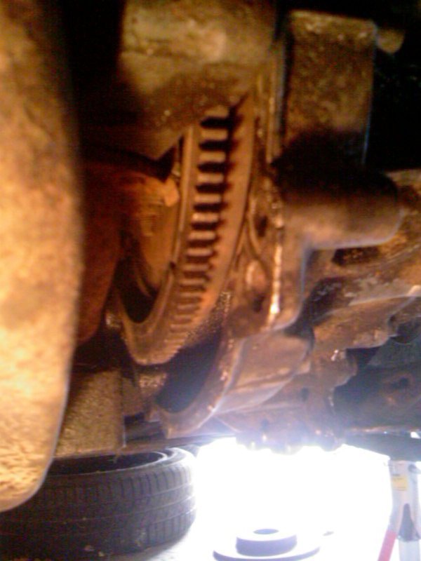

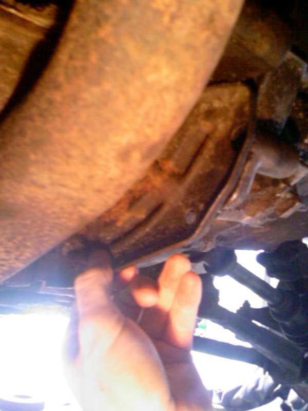

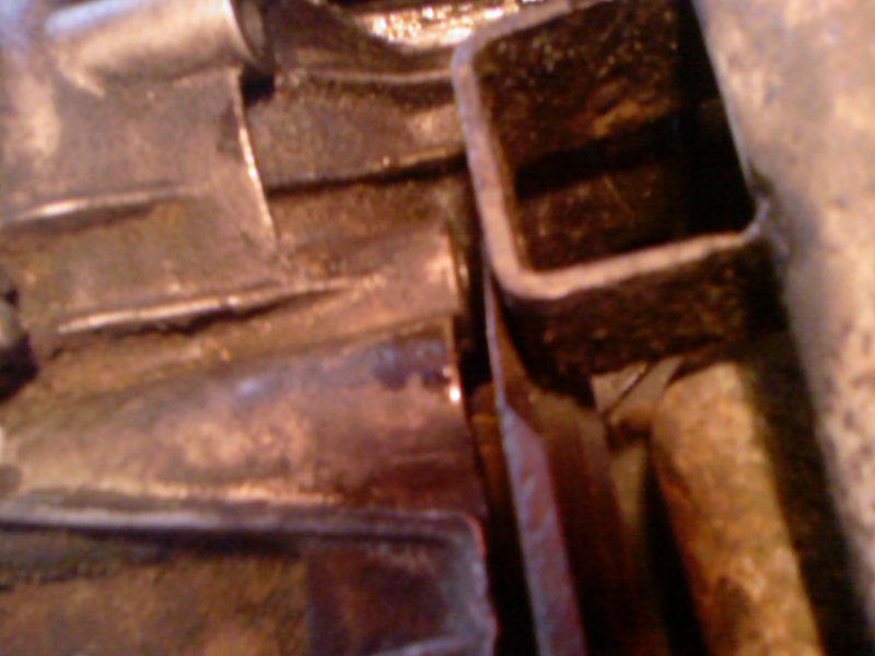

Foltan 0 Posted April 14, 2008 Ok ive got some pictures which may help to clarify, though they're not that clear First things first, this is the cover that i'm trying to put on and this is roughly where it goes something like this notice a hole in the top right corner of the cover lines up with a hole in the box, though the marks on the cover imply that the hole slightly lower down were used previously the other holes lines up at the back and with the mount on the exhaust, though there's alot of gappage so it would never fit tightly however i've never really bolted this cover in becuase whenever you try and put it flush with the gearbox it fouls on the flywheel, as if the bell housing needs to be 1cm longer towards the car im a bit lost Share this post Link to post Share on other sites

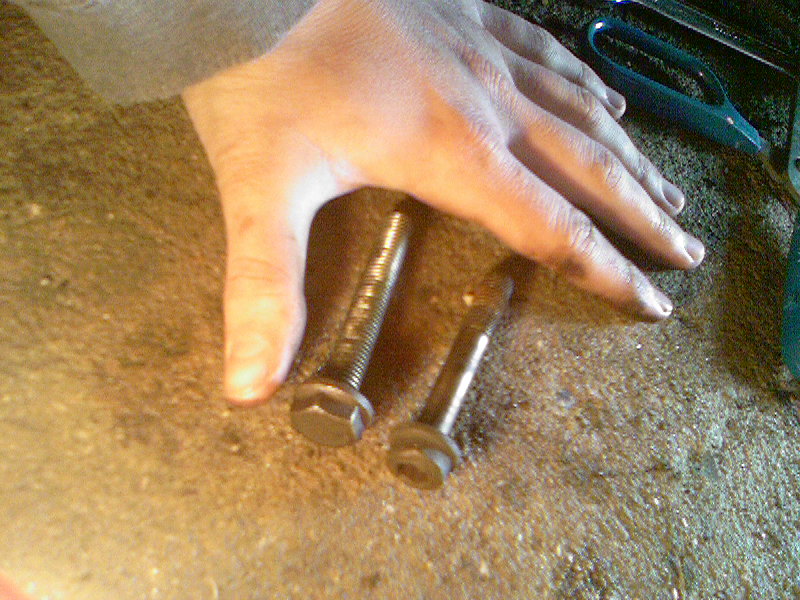

Foltan 0 Posted April 14, 2008 oh and these are the bolts 'left over' sorry to seem a bit unprofessional! though i think there is probably meant to be a nut with the half threaded bolt Share this post Link to post Share on other sites

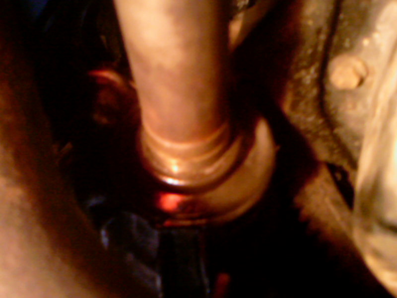

Foltan 0 Posted April 14, 2008 and finally, the leaking seal, you can see the oil dripping from the rubber cover. if this is pushed up tight then it stems the flow but pull it back and it pours pretty fast what do i do?! Share this post Link to post Share on other sites
christopher 5 1 Cars Posted April 14, 2008 (edited) I take it you have an iron block? Since mine doesn't have a gearbox cover. Your gearbox seals are almost definately leaking. The rubber part is just a dust cover I think. Not sure you even need to use it actually. In any case you should replace both sides. These are the part numbers: 312144 312146 They are fairly easy to change but you need to pull the driveshafts out again I'm afraid and drive the new seals in with a drift. Just prise the new seals out with a screwdriver (carefully). AS mentioned make sure everything is nice and clean when you put everything back together. The bolt on the right BTW are the ones at the top attaching just under the head.. Edited April 14, 2008 by christopher Share this post Link to post Share on other sites
welshpug 1,737 Posted April 14, 2008 quick tip, make sure the intermediate bearing housing is spotless, I had quite a bit of difficulty getting a driveshaft to seat properly a few weeks ago purely down to a tiny layer of rust in the housing (no amount of swearing banging or tightening the 2 L bolts made any difference) a few minutes with some emery paper and WD40 sorted it out and the bearing slid straight in against the shoulder and stopped the same leak you have. Share this post Link to post Share on other sites
Foltan 0 Posted April 14, 2008 yeah a friend suggested to me that the driveshaft may just not be in completely. the bearing was a complete mission to get into the housing, tonnes of bashing, so theres a good chance its not in completely. I've got to take it out anyway i guess so i'll give that a try first and if that fails then i'll get new seals. can't be much harm in doing them i guess as they aren't too expensive. cheers for the part numbers chris Share this post Link to post Share on other sites
