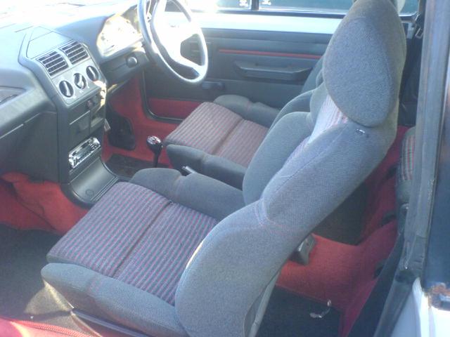

PhilCTI
I'm sure my carpet was fitted quick just to spruce it up a bit by the previous owner before selling,
you can see what I mean about the plastic sticking out too far
the carpet running up under the seats is all baggy, I think it just needs gluing down,
needs a hoover too, but I don't know how that works!
hope that helps
