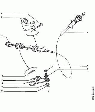

I've done a search for a clutch problem I have.
Seeing the Pic of the clutch set-up below.
My problem seems that the lever through the BellHousing is sitting out of line with the short rod (item 4) shown.
I can move the lever to make the rod inline, but when the clutch is operated it suddenly jumps back out of line.
Then I can't get any gears.
Is there a fault inside the BellHousing with the lever or a fault with the rod ??

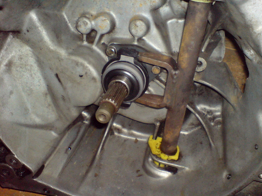

Any more Pics of the lever where it engages the thrust bearing. ??
Like this one:
But this is not the clutch system I have.

No not yet, as I want to be sure its not an external issue first, such as the cable and lever system before I remove the Box.
quite possible that the triangle shaped arm bolted to the box has bent (part 5 in the pic above)
or it could be a broken ball stud in the bellhousing.
whereabouts are you in Mon? if you're not too far I could have a look for you.
If you haven't already done so, check all the gearbox bolts are tight like others have suggested - the lower rear 8mm allen head one that screws in from the engine side in particular has a nasty habit of falling out, and is much more common a fault than the release bearing dragging sufficiently to stop you getting it in gear.
I'd guess that in probably 50% of the 205's myself or friends have owned that pesky bolt has worked its way loose and caused selection problems - it's the first thing I check with any gear selection / clutch type issue.

I dont think the ball is broken as it appears the lever going through the bellhousing is pivoting on the ball, but you can move it sideways pivoting on the ball. Which throws the short rod out of line. I'm beginning to think the problem lies with the thrust bearing end of the lever.??
Should the rod (Item 4) be fixed in the cup pushing against the lever.??
