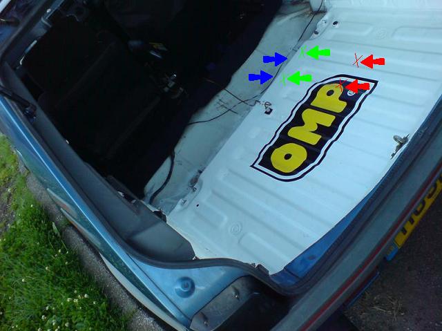

Anton green 12 1 Cars Posted March 6, 2008 (edited) I have my six points to get finished off soon - it has been sat in the garage with 3 points finished for quite a while now, but have been thinking about the best place to mount the rear harness eyes. What do YOU think? red (on top), blue (by the seatbelt mounts) or green (on top)? Edited March 6, 2008 by Anton green Share this post Link to post Share on other sites
Bonzai 2 Posted March 6, 2008 if you are competing, then i think there is a certain angle the harnesses have to be at? probably find it in the MSA blue book...? Share this post Link to post Share on other sites
Anton green 12 1 Cars Posted March 6, 2008 Im not competing yet, but I would love to do some autotesting at some point in the near future. Hence do not have a blue book as of yet. I have to get the details for the msa sorted at some point, but right now I'm concentrating on building it! If someone copuld tell me a good place for harnesses in a 205 which complies with the MSA requirements that would be cool. Share this post Link to post Share on other sites
cybernck 400 1 Cars Posted March 6, 2008 i'd put a harness-bar between the C-pillars and then strap the harness to it. Share this post Link to post Share on other sites
large 33 Posted March 9, 2008 If you can get hold of a blue book every thing is in there even how to build the car as different forms or motor sport have different requirements. What are you planning on doing? Share this post Link to post Share on other sites
Anton green 12 1 Cars Posted March 9, 2008 Autotesting. Fairly low speed stuff, for fun and experience really. I don't believe I will ever need to use the extra capabilities of the harnesses but it will be nice they are there, plus the added safety on the highway. I will find myself a blue book to discover where to put harness eyes, which also comply with MSA requiremnets. Djinuk - If you are competing it may be worth looking at the positioning too, to make certain the location complies with requirements. If you are doing trackdays/other non competitive stuff then the first replies to this thread will do you nicely Share this post Link to post Share on other sites
