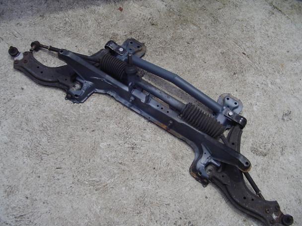

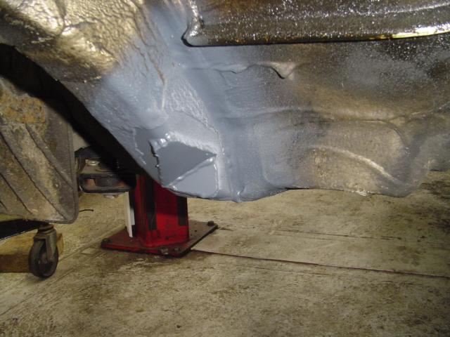

If you've got a relentless sense of adventure and you can fabricate/design suspension (or more precisely in my case, get Colin Satchell to turn your hare-brain scheme into a useable reality), you can use 306 wishbones to widen the track and move the mounting points to increase wheelbase and re-dress the front roll centre all at the same time. Easily cocked up if you don't know what you're doing though!
Completed subframe:
Notched chassis leg:
Worked very well overall, but the bump steer needed a little refinement (as with any lowered 205/309 actually). Traction in particular was spectacular out of corners.

good grief, that must be a monumental increase in track width! ;)

good grief, that must be a monumental increase in track width! <_<
From 1407 to 1490mm! It *just about* fits under standard arches on a 309, but it does look comically wide parked next to a regular 309.

Hybrid shafts, I could use 306 shafts if I had a Peugeot box, but this is my Honda powered one which has Honda inner and Peugeot outer CVs, with made up bar shafts. The wider track helped with the angle of the shafts, because the Honda inner CVs are further apart than Peugeot.
