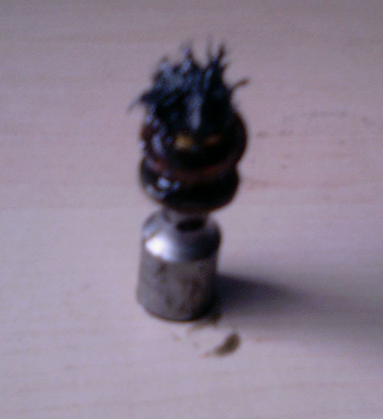

Jrod 7 Posted March 3, 2008 Box is off and ready to be binned, only took me 75 minutes which included the sump guard which I don't think is to bad! plenty of metal on the drain plug.... Share this post Link to post Share on other sites
