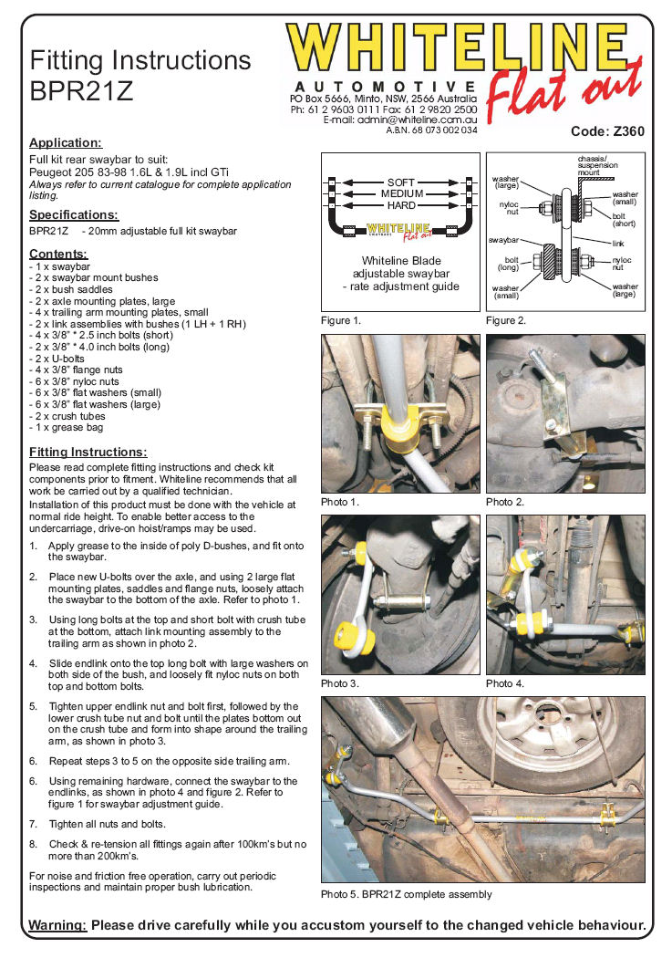

Anyway onto the exciting bit, I finally fitted my Whiteline adjustable rear anti roll bar (£100 from Balance Motorsport). It was a fiddly bastard of a job but I managed it by following the attached guide.

I had a bit of a problem with the supplied bolt being too short on the left hand side of the car, I'm guessing that was down to manufacturing tolerances and it was easily solved by buying a pair of 10x110m shanked bolts.
I can't really give an assessment of the performance yet as I've not had chance to give it a good run, and with the above problem with the bolts it took me 3 weeks to get the car back on the road! Just got to sort out the rattle on the exhaust now, its not terrible but its annoying especially when sat idling.
To be honest I was a bit surprised about how it attached and I'm not entirely happy as it looks a bit of a bodge, but I guess if it works its alright.

Well although they don't look it, the trailing arm mounts feel solid and they don't make any noise when driving so I would assume they're holding just fine?
It does feel different, but I know having spend over £100 and hours fitting the thing I'm bound to 'think' it feels different. I'll have to have a play with the settings when I'm on track.
I have to say I think that looks dire. Its not even executed well, for example the clamp brackets round the beam tube could be made much nicer without much thought or effort. As for the attachment to the trailing arm, thats shocking IMO! A nice bracket to pick up on the caliper bolts, or even a different stub axle supplied with a pickup on the back of it would be much better.
omega
have to agree with tom it looks so cheep and horrible and even though you have fitted it as per instructions,but if it works then its money well spent
Just to add- please don't think I'm putting you down because I am not intending to- but Whiteline Motorsport really ought to be ashamed if that is the best they can come up with for a kit. I've had a thought and a machined alloy saddle to sit on the beam for the bar mounts, and a titanium stub axle with a tapped hole on the rear side to accept a rose jointed drop link could make it much much better.
Golf ARB's are much the same thou, Look horrid but do help. But as said it could be made allot better then the cost would go up so it's one of those things again,
