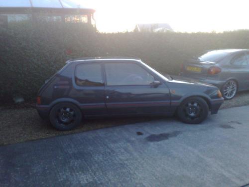

i know i am going to get crucified on here for doing this but here you go, i get no scrapes etc but i have no rear seats so its quite light.
danpug
If you ever have people in the back of your car don't go that low!! You end up replacing the fuel pipe in the arch very frequently.

did you have the arches rolled for the 15" wheels to fit?
i think that might be a touch too low. but thanks for the picture
i never carry back seat passengers, only parts for pug gtis :)

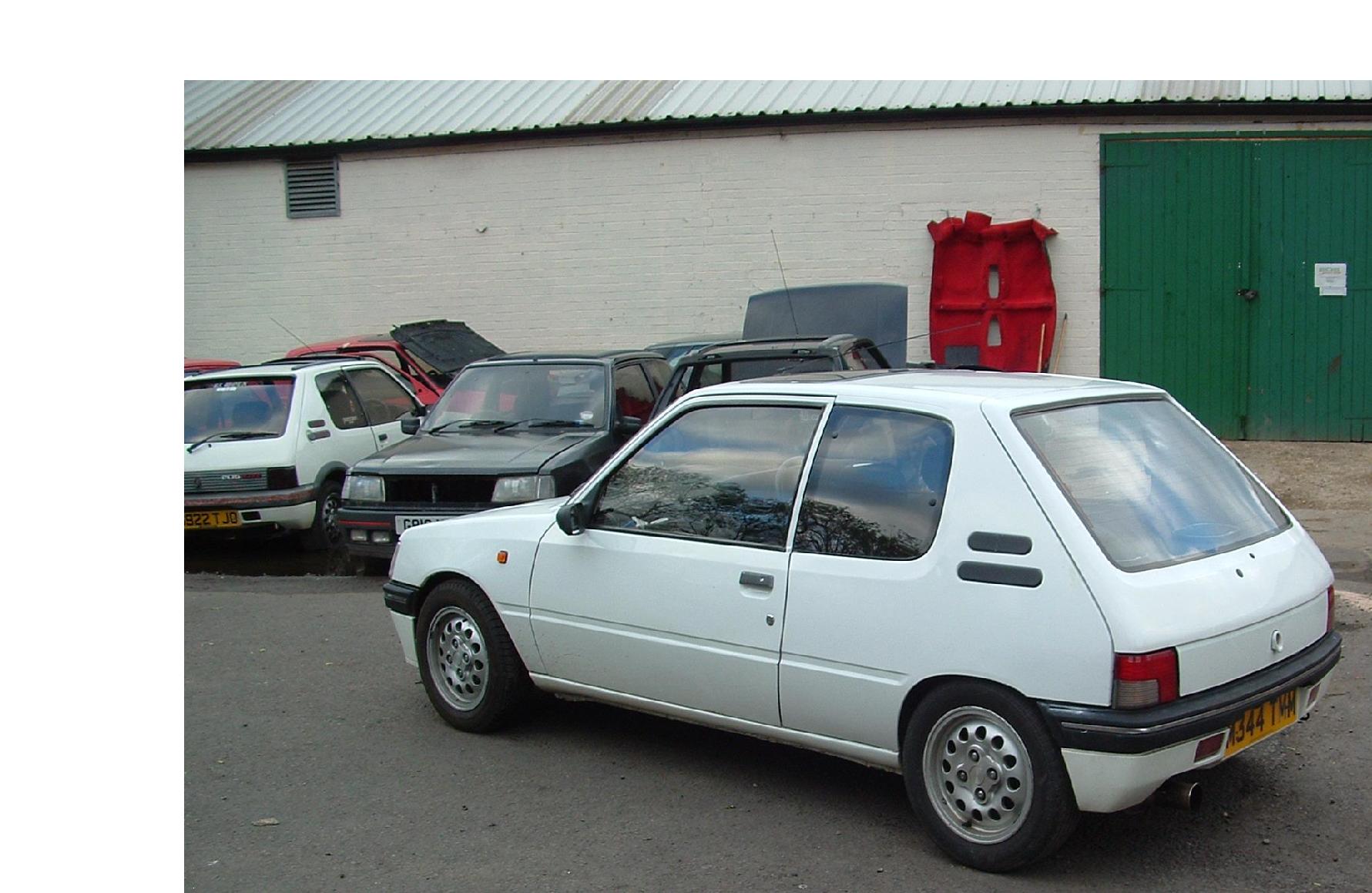

here's a picture showing the car on std springs and 15" speedlines
and after fitting the shorter springs
i didn't know what sort of drop the new springs were. but when i initially measured distance from centre of wheel to edge of wheel arch it was 370mm
after fitting shorter springs, it was 300mm :D:)
tom_m
too low IMO! :o
paul205mi16
Blooming hell, Thats really low evan with 14" wheels.
jord294
it seems to drive ok. no nasty knocking noises :D
only a 1.1, so not designed for high speed cornering :)
