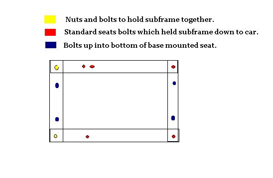

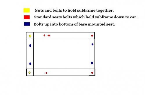

I used the standard seats mounts with thick bits of metal bar.
Imagine that is looking down at the drivers seat from above.
Make sure you use nice strong bar. You may also have to alter where the across pieces sit for where you want to sit / how far the holes on your seat are apart.
