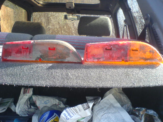

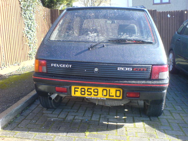

McDude 33 Posted February 22, 2008 I have recently bought a 91 H plate 1.9 and it has the Phase II lights, but I'm starting to think it shouldn't have. I also think that the previous owner f##ked the task up of fitting them because the reverse light lights up essentially where they should on phase I rather than on the lower valance. I'm a bit confused and wondering how to rectify - I think I only need the proper reverse light for the valance and to mock up a bit of loom. Either that or there is a wierd electrical short. Share this post Link to post Share on other sites

steve@cornwall 100 Posted February 22, 2008 sounds as if the prev. owner has fitted ph2 lenses over ph1 lights!!! Share this post Link to post Share on other sites
McDude 33 Posted February 22, 2008 Damnit! Steve, I think you are right. Just been outside to look and that makes perfect sense. Okay, what do you reckon my best course of action is? I guess it is 50/50. Either fit a reverse light and plumb it in or get some phase I lenses. I'm kind of attached to the Phase IIs though. Share this post Link to post Share on other sites

McDude 33 Posted February 24, 2008 I've ordered some phase I lenses from eBay - it can go back to original for the time being. I'll probably keep it that way too as I want it to look as PSA intended. I now wonder what phase I have 1? 1.5? 2? I have red carpets, the dash is the newer shape and is dark grey (rather than black). The seats are the black/red ones. Looks like my rear lights are phase Is!!! I'm guessing phase 1.5 - I used to have a phase II with grey carpets/black dash. It was an L-plate cat model. Share this post Link to post Share on other sites

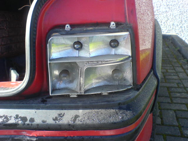

jodycraw 0 Posted February 26, 2008 It's not possible - the lens is a different fitting to the cluster arrangement underneath, so it doesn't fit. Might be Ph 2 light units wired incorrectly. Also you don't need a reverse light to pass the MOT, mine doesn't have one. The reverse lights didnt work on the Ph1 lights either though! Share this post Link to post Share on other sites
steve@cornwall 100 Posted February 26, 2008 It's not possible - the lens is a different fitting to the cluster arrangement underneath, so it doesn't fit. Might be Ph 2 light units wired incorrectly. Also you don't need a reverse light to pass the MOT, mine doesn't have one. The reverse lights didnt work on the Ph1 lights either though! Direct fit! This is a ph2 cluster - Share this post Link to post Share on other sites

McDude 33 Posted March 3, 2008 I fitted the Phase I lenses and everything is alright! However, the half-jobbing of the previous owner is despairing - he had obviously realised that everything wasn't quite right because he has padded and taped over the top bit of the indicator so that it wouldn't show up on the phase II lens. He used toilet paper and parcel tape!!! On the NSR light the parcel tape had melted to the indicator bulb from the heat. I've got my fingers crossed that he didn't turn his hand to anything more serious - drinking straws for brake pipes? chicken bones for conrods? steve@cornwall - you are on my valentine's card list. Share this post Link to post Share on other sites
