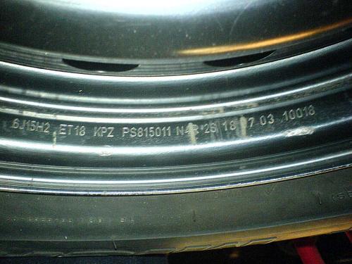

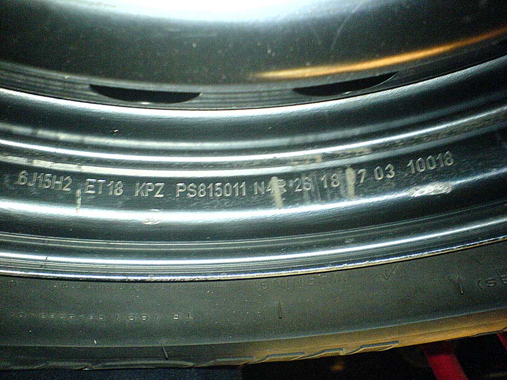

No, the alloys are ET 18 - take a look at my picture it says 6x15 ET 18.

They are the alloy ones ive just bought them!!! BARGAIN. Right to clear this topic up once and for all on the light weight c5 "steelies"
Mine still have citroen stickers on and says 5401.Q8, they have same stamped number as the one gentrix posted. Ideally you want to be using the proper c5 bolts for these with spinning taper washers,although not sure if thread same?
The best way to find if they are the alloy ones is to simply ask the seller if a magnet will stick, if the anser is no then they are the alloy ones! Many thanks to sandy and gentix

did a search on krono.. whotsit company
PS 815011 Citroën C 5 03/01-09/04 6 J x15 H2 18 4 x 108 x 65 17,969 Ft 21,563 Ft
umm.. a picture
so only available from 01-04... perhaps that explains the service box thing..

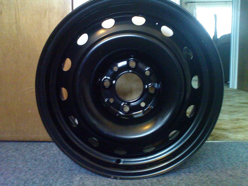

right i have a set of the 5401.H7 which weigh in at 7kg exactly and look like this:
