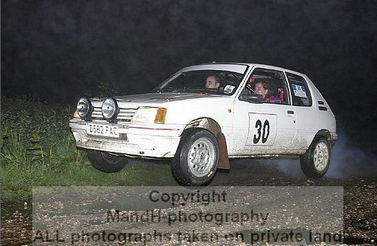

Well we've had no problems with an OMP cage and we've been over a fair few bumps! They are FIA approved so must of done soemthing right?
(don't have the actual picture of us going over it but we did! :blink:)
I agree the OMP is a bit more work to fit but it depends if you are willing to do a bit more work to save a bit of cash?

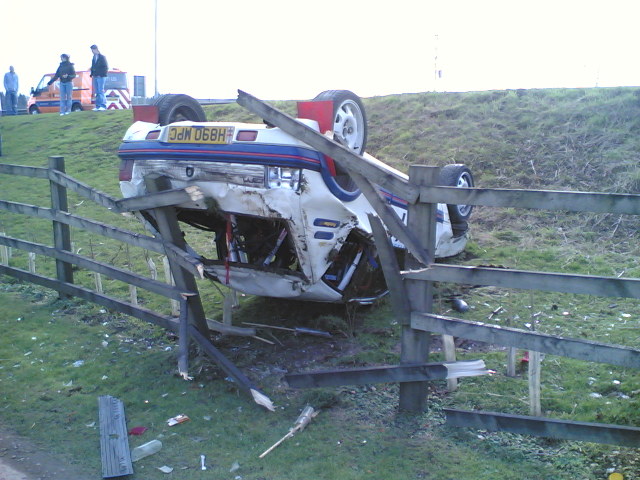

omp cages work!!
thats why i bought another one in my "new" 205
Jrod
Ouch.
hodgy
i look back at it now and laugh :)
:P

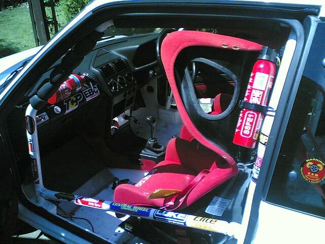

Omp cages may be a bit more time consuming to install but there no big issue really.
