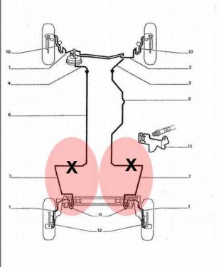

de Noir 0 Posted January 29, 2008 (edited) Need pictures of rear underbody & brake lines, factory or tidy custom install! With focus on fuel tank bay piping, especially items 6-7 joint and L/R compensator positions, or put simply - zone marked red. Thanks in advance.. Edited January 29, 2008 by MH_ Share this post Link to post Share on other sites
pug_ham 240 3 Cars Posted January 30, 2008 The brakelines around the fuel tank have the compensators fitted as marked by the X's added to your original picture. The pipes run along the front of the tank with the compensators approximately evenly spaced between each end but tbh if you aren't using standard pipe its you can fit them anywhere you want. The pipes go over the corner of the tank at each outer corner next to the sills & then down the side before turning to the two brackets on the rear panel behind the tank for the flexis around the beam on each side. The 309 GTi has them on the engine bay rear bulkhead. Graham. Share this post Link to post Share on other sites

de Noir 0 Posted January 31, 2008 (edited) Thanks guys, this is exactly what I needed. I'm not avoiding to remove fuel tank, as everything is already removed from the shell... I'm trying to install everything back neatly to a bare shell. Got new copper OE brake lines, plastic clips and everything from Peugeot spare parts. Started from solid-flex pipe bracket at rear end, would not like to come too short or too long either at the front. I'm making a mock-up for every pipe, and then bend the real stuff with bending tool. Took some photos before stripping all down, but turned to be wrong almost useless details on them. Edited January 31, 2008 by MH_ Share this post Link to post Share on other sites
pug_ham 240 3 Cars Posted January 31, 2008 If you're trying to avoid removing the fuel tank you won't be able to! You can replace the pipes that run over the side of the tank without removing it if you are determined enough. I've managed to do a couple before with the tank simply lowered about an inch on the rear threaded mounts. Crafty use of a suitable piece of wood helps get the new brakepipe back into the clips above the side of the tank. Not particularly good if you are a stickler for neat & tidy run of pipe but they aren't visable so only you need know. If the tank is off though you should be able to make a near exact replica of a factory install. Graham. Share this post Link to post Share on other sites
