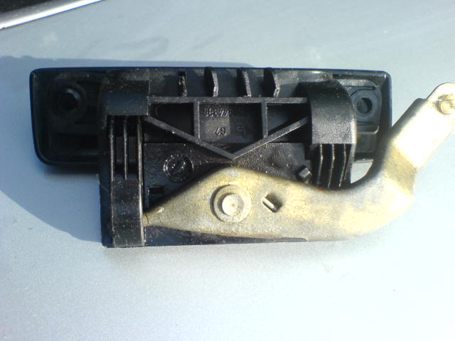

steve@cornwall 100 Posted January 24, 2008 Chances are that the door handle has partially seized. The metal arm in the pic. should be sprung to return to the down position, but when not used for a while sticks up and has the effect of trying to unlock the door with the handle slightly lifted, try it - door won't open. Take the door handle out, 10mm nut inside and pop out the bolt, torx bolt under the outside of the handle. You may need to "modify" the little lugs that are on the bottom of the handle mech to get it to clear the door skin. Then just pop off the wire from the handle. Liberally coat all accessible parts of the riveted pivot in the centre of the arm and work 'till it springs to the right position, then refit! Once the handle is removed, the door should open with the interior opening handle. I took this pic. last week when I did the passenger door on ther cti which had decided not to open after a few months of not using it -I knew it would be needed soon Share this post Link to post Share on other sites

pug309twin40s 1 Posted January 29, 2008 update. door lock is fully functioning again!!! lever as steve said was slightly seized so bit of wd40 and fully working again but after much fitting and still not working found the arm was slightly bent iswell catching on the bracket for the window runner. bit of bending back and all is well again. apart from the stupid little white clip keeps coming of the end of the door key lock!! must find the spare one i got somewhere. Share this post Link to post Share on other sites
