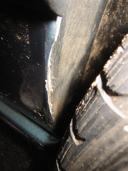

Right so over the christmas break fitted a 309 beam to my car (rebuilt) and after taking it for a little test drive it has bent the passenger side rear 3/4 arch (not the plastic trim) on the lower section under the trim.

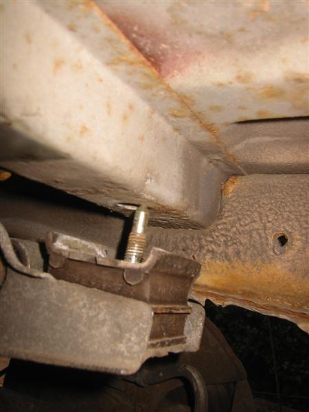

Is it possible that the front mounts are allowing some movement and this has caused it to move forwards and touch the arch ?

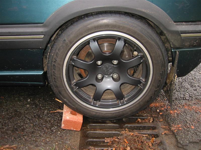

Spooky this! I commented on this topic http://forum.205gtidrivers.com/index.php?s...c=84305&hl= and then the other day I went out and had a fiddle (with the beam). The drivers side is an inch between tyre and front of the arch and the passengers side is 1/2 an inch. So I loosened all the beam mount bolts, put the hand brake on and dragged it forwards and even chocked that wheel for good measure!
Then I tightened it all up. It seemed better.... untill I took the brick away and it was no different. This is the result
I think I am on 1.6 beam mounts. If I switch to 1.9 ones, will that move it back 5mm? That is all I need. It will be fine once the tyres wear down a bit too! Also the PTS rims sit very wide on a 205 beam, though I didn't have this problem with my 7x15 ET15 wheels before with Eagle F1's after I rebuilt the beam. Infact it did catch on the other side on the previous beam, as can be seen in the first post.
One other thing is that the beam seems slightly offset on the passengers side (sits wider) than the drivers, judging by some wear on the arch, but it has had a drivers quarter on at some point in its life (a genuine panel though).
I too was thinking about front mounts having gone as why else would the beam move forward. The wheel moves back when under load as I found out with the brick under it.

I think I have cured this today!

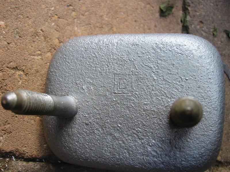

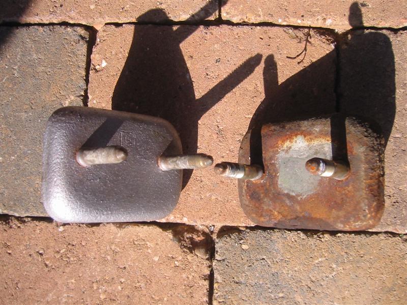

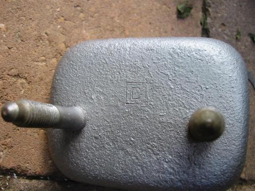

Finally dropped the beam and fitted my 1.9 GTI front mounts. The 1.9 mounts can be identified with a D and a G on them. The 1.6 ones don't have a sided marking on them
Here is a pic of the 1.6 on the left and the 1.9 on the right. I have tried to take it aligned to the block paving to give an idea of offset.
A quick blast up the road over bumps that had historically caught reveals no noise! :) I had to undo and adjust the rear mounts as well to get them back in the holes. Here is a pic that shws what extra distance I gained
It needs a better road test to complete the exercise. I put paint back over the area that had scuffed so I can see if it does it again
