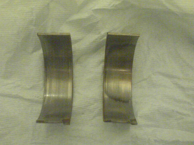

5150maxie 0 Posted December 19, 2007 Should just be with the crank if everything is OK. It is the pressure form the tightened crank pulley bolt that drives the pump and is an absolutly naff piece of design if you ask me. If the bolt is loose, then the stop light will most likely be on when running. Don't let it run for too long like that, just check the bolt torque it up and try again. HTH the crank bolt is tight and will not go no more as the engine turns,i could do with a lockin tool just to make sure.the pumps turns ok by hand i think its a design on early ones as iv read. heres my main bearing Share this post Link to post Share on other sites
5150maxie 0 Posted December 19, 2007 sorry to carry this thread on a bit, but i have just double checked and tightened the crank bolt properly and locked the fly wheel.Now the oil pump chain does not move my hand :)a least i ve cleaned everthing.just waiting for my new shells finger crossed i ve sorted it. Thanks for all your advice. Share this post Link to post Share on other sites
5150maxie 0 Posted December 21, 2007 (edited) sorted it i have perfect oil pressure every thing is working perfect thanks for all your advice.this is my christmas presant theres me saying i havent got time! Edited December 21, 2007 by 5150maxie Share this post Link to post Share on other sites
