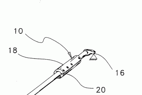

If you're up for some experimenting I came across the description of a US patent for a torsion bar stiffener that looks very simple to make and also looks like it should be quite effective too. Might be worth playing with?
http://www.freepatentsonline.com/5354041.html
If you register on that site you can view pics (scroll down)
That is for a bar that is fixed at one end like a Morris Minor or my Isuzu front suspension (no springs) but an excellent idea and an excellent site.
I suppose that as those ideas are not patented in UK then it is OK to use them :rolleyes:
Yes, or the rear suspension of a 205..... However I don't see why the same idea wouldn't work on an anti roll bar too (which is just a torsion bar after all)
Absolutely. Although I think it would also be ok to make one for personal use in the US too, you wouldn't be able to sell them though.
The arb is only fixed to the wheels and for instance does nothing at all during straight and level braking to stop the nose dipping.
To stiffen the action one would need to shorten the fixing points at the wheel end, if you get what I mean.

Maybe I'll have a look at the back one when I get around that end. It would be nice to be able to thread the ends of the arb and fit threaded tube to it for ultimate adjustability post-9302-1197035003.gif Think I'll patent that :rolleyes:
People also fit thicker (stiffer) front anti roll bars (like the 309 bar) and I don't see why this modification wouldn't have the same effect?
Its of more value on a 205 at the rear of course, but if this works it would be a simple bolt on mod that would fit most cars, I'm amazed they aren't in production, patents are probably the reason though B)
