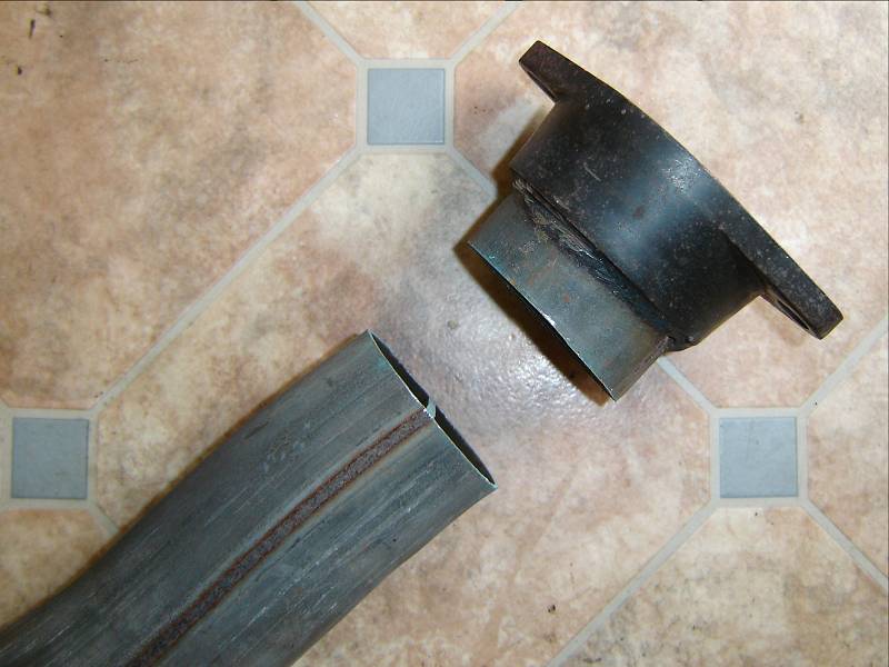

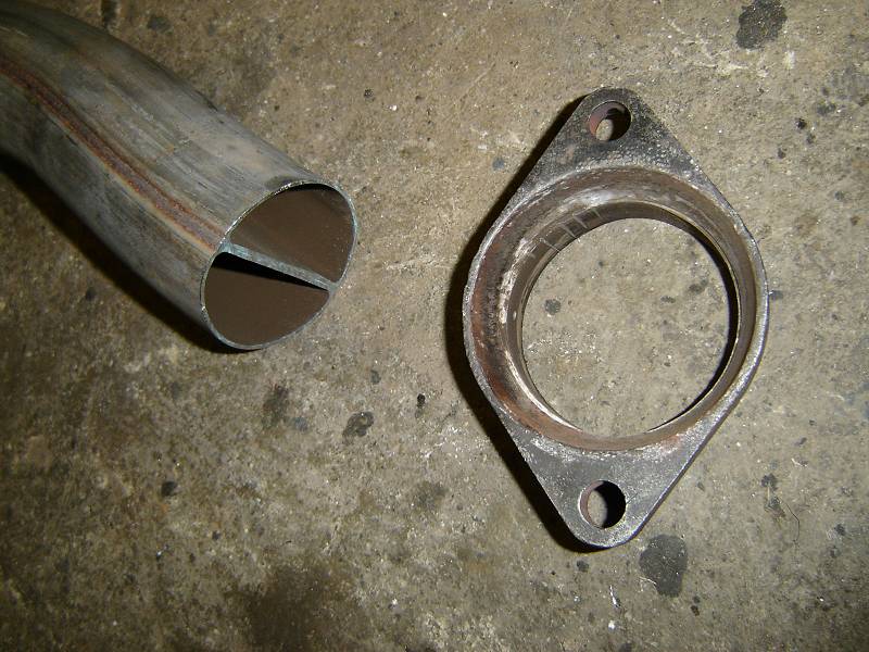

Ryan 99 Posted November 25, 2007 This is mine. I cut the pipe about 15mm away from the flange, which counting the part inside the flange made it about 30mm shorter overall. The exact measurements vary from car to car and according to how much the manifold was altered by. You might need to remove more. Then I filed off the weld holding the 30mm section in the flange and removed it. Then I did as above - bolted the flange to the manifold, and offered up the downpipe until I got it where I wanted it, then marked it and got it welded. I also had a line of weld put across the end of the divider, as I'd seen one where it had split and the two halves peeled back and blocked the exhaust. Share this post Link to post Share on other sites
