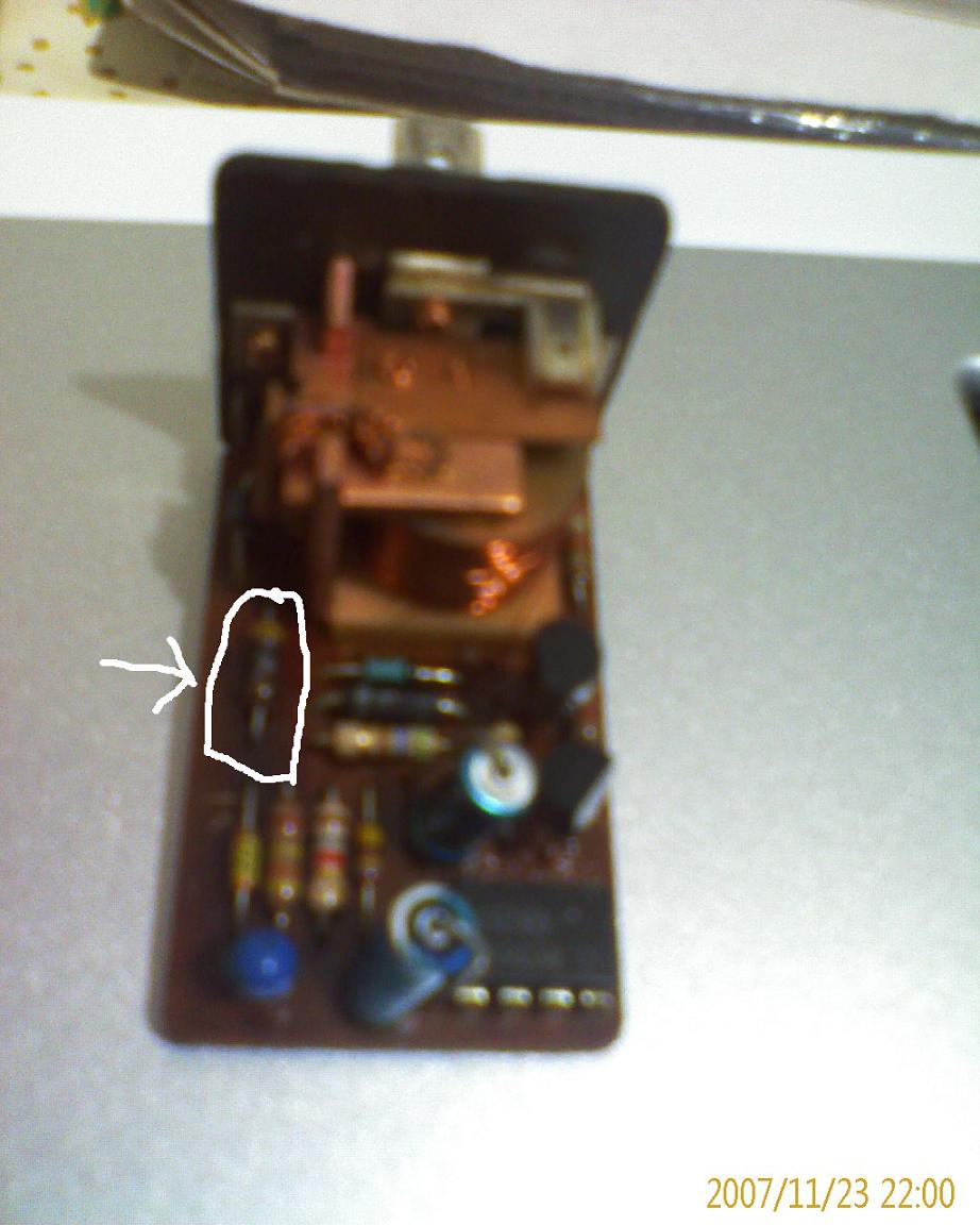

eu_andreiutz 0 Posted November 23, 2007 Hi, I can see on mine that a resistance (?) is blown....the brown one in the left up part of the picture (sorry for the blurr)http://www.99poze.ro/Tachy_relay_peugeot/1 Can someone tell me where can I find a Tachy relay diagram? I don`t know what to replace it because it is blown and I can only see it`s ends. Any idea? What does this do? Efectively- I know it starts the fuel pump and the injectors...but how does it do it? Also I have another problem....after finally getting the engine started it can`t keep the idle and it doesn`t sound too good when I rev it up. Thanks for any help provided. Cheers Andrei Share this post Link to post Share on other sites
DamirGTI 362 Posted November 23, 2007 (edited) Hi ! Well this tachy relays are easy to repair - if it's just blown resistor go and buy another one (in some "Chip" store ..) , remove the blown one out and solder the new resistor back inside ... This is the fuel pump relay it switches pump priming on – off , as for wire diagram it's best to buy Haynes book inside you will find complete wiring diagrams .. or download short PDF version from here : http://www.205gti.com/downloads.htm Cheers ! Damir Edited November 23, 2007 by DamirGTI Share this post Link to post Share on other sites
eu_andreiutz 0 Posted November 23, 2007 Damir the thing is that I can`t see what kind of resistor it was....so can u tell me? or take a picture of one....if you have it. Thanks Andrei Share this post Link to post Share on other sites
Roman 0 Posted November 23, 2007 hello i think that resistant is 1.2 k ohm(but i check tomorow in garage) to be shure Share this post Link to post Share on other sites
DamirGTI 362 Posted November 24, 2007 Just take this relay with you to the Chip store and show it to the guy who works there and he will find you identical new resistor .. anyway it must be of the same color markings ... and thats how you will buy new one - same color marks on the resistor , same resistor resistance value .. if I'm not mistaken Cheers ! Damir Share this post Link to post Share on other sites
eu_andreiutz 0 Posted November 24, 2007 Dude I know I can do that but don`t you understand I can`t see the colors....it is blown....it`s black....no colours.... Anyway...I bought a 1.2kOhm resistor and fitted.....still it doesn`t activate the fuel pump....the rest is working. I put the fuel pump directly with the ignition...the engine fired and started. Some problems apeared: 1. Some misfireing in the exaust quite a lot....in the intake just a couple of them. 2. The idle is still erratic...not too good. 3. Accelerating is pretty erratic too. 4. Idleing is reving up itself then reving down....then up again and so on. Tomorow I will put some videos I made with my phone maybe you can help me. Thanks. Andrei. Share this post Link to post Share on other sites

Bassman 1 Posted November 25, 2007 (edited) I would also be careful, a resistor doesn't just cook itself unless there it is dissipating more power than it is rated for. I would check the relay contacts are clean and that all the pins to the relay are properly soldered in. I had a problem with mine that a poor relay contact caused one of the pins to cook and partially de-solder itself causing poor starting. Cleaned it up and re-soldered and it is ok at the moment. Links to photos here of my relay: Relay Dry Joint Relay Innards Edited November 25, 2007 by Bassman Share this post Link to post Share on other sites
eu_andreiutz 0 Posted November 26, 2007 (edited) Graham, They are in the correct order....and the timing was ok...I never removed the timing belt....so it should be fine. About the AFM I can`t say the same thing....the guy I bought it from said he opened it and modified the flap resistance....I`m trying to fix it now but I don`t know where the original position is. Bassman I will look today at the solder joints but they were fine the last time I looked. Anyway our relays aren`t the same after I saw yours....the number pins are the same but the parts inside are diferent....prbobably another year os something. I still believe it it just a fueling problem...too much fuel or not enough....because of the afm Thanks...I am open to other ideas... Andrei Edited November 26, 2007 by eu_andreiutz Share this post Link to post Share on other sites
