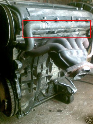

ChrisG 0 Posted November 22, 2007 Right peeps, does anyone have a scan or link to a diagram of the 1.9 Mi16 oil and breather pipe setup? I've a nasty feeling I could be a few pipes short of a system (or so I've been told, athankyou!) and want to check before I plonk my engine in. Any help is mucho appreciated Chris Share this post Link to post Share on other sites
ChrisG 0 Posted November 22, 2007 Cheers Ryan, thats spot on What is this pipe, as I don't think I have one? Share this post Link to post Share on other sites
cybernck 400 1 Cars Posted November 22, 2007 ^ that's a water pipe . Share this post Link to post Share on other sites
ChrisG 0 Posted November 22, 2007 ^ that's a water pipe . Bugger, I thought it was ans suprise suprise I don't have one Share this post Link to post Share on other sites
Ryan 99 Posted November 22, 2007 you can bypass that pipe if you don't have one. Apparently it's only there to warm the engine up quicker using heat from the exhaust. Loads of people get rid of it to reduce the clutter in the engine bay. Just block off the outlet on the back of the thermostat, and the same on the distribution block on the back of the engine (or swap it for the 205 block which has one less outlet). Share this post Link to post Share on other sites
